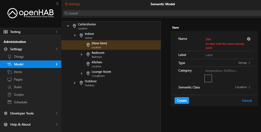

Am at the stage of setting up semantic model and adding my newly discovered equipment to the model. This worked fine for two locations but when I selected the equipment to add to a third location, the location disappeared from the model. If I try adding the location into the model again, it says it already exists (see image below). But it’s nowhere to be seen and I can’t select it.

First try reloading the page, clearing the cache of the browser if a simple reload doesn’t work. Then try restarting OH and reload the page again. You don’t need to delete the model itself.

Use the API Doc Explorer (under developer tools) and query for that Item. Does it exist in Items? Is there a Link to that Item? Groups should not be linked to Channels so that could cause some issues.
