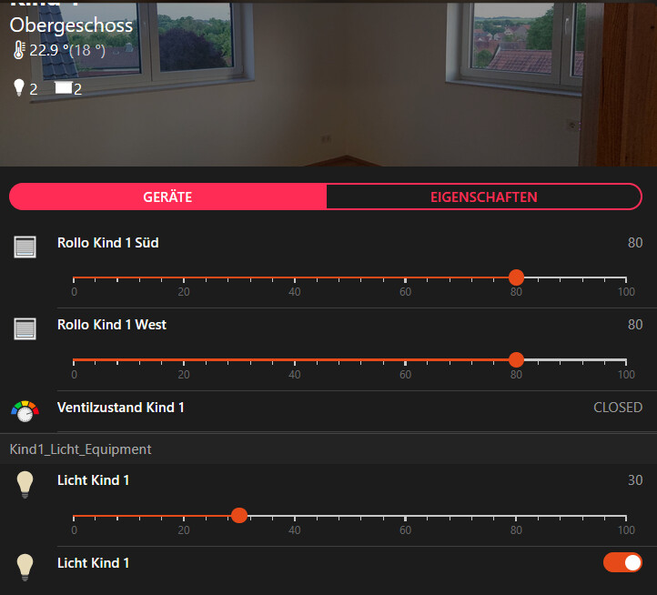

Location Badge counts semantic property “Brightness” as light
When I turn on the light in the room, the badge displays two lights on the location card.
The AI told me to add a Equipment, so I did in room “Kind1” - no change so far.
Can someone help me figuring out what is going on, please?

grafik

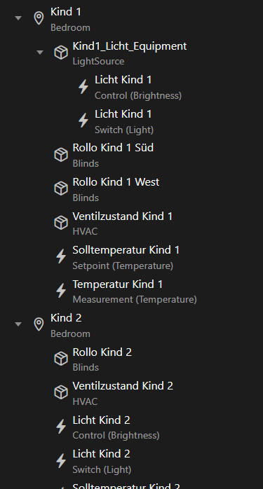

grafik
version: 1
items:
  KNX_OG_Dimmaktor_1_Licht_Kind_1_Dimmer:
    type: Dimmer
    label: Licht Kind 1
    icon: light
    groups:
      - alleLichterOG
      - Kind1
    tags:
      - Brightness
      - Control
grafik
(Funny, I just noticed that “Light Child 1” (the light switch) is also in the group for Child 2. But it doesn’t show up there…)
version: 1
items:
  KNX_OG_Dimmaktor_1_Licht_Kind_1:
    type: Dimmer
    label: Licht Kind 1
    icon: light
    groups:
      - alleLichter
      - Kind2
      - Kind1
    tags:
      - Light
      - Switch

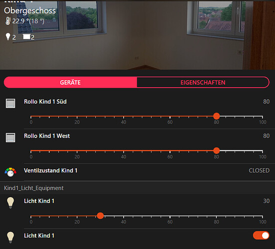

Finally, here’s a screenshot of the Properties homepage I mentioned. Both items are currently listed there.
I just noticed in the “Home Page” definition that I also specified an expression for the blinds there.
Here, I can simply split the lights into two parts in the “Locations” where I have sliders and switches.
