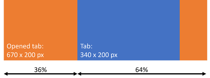

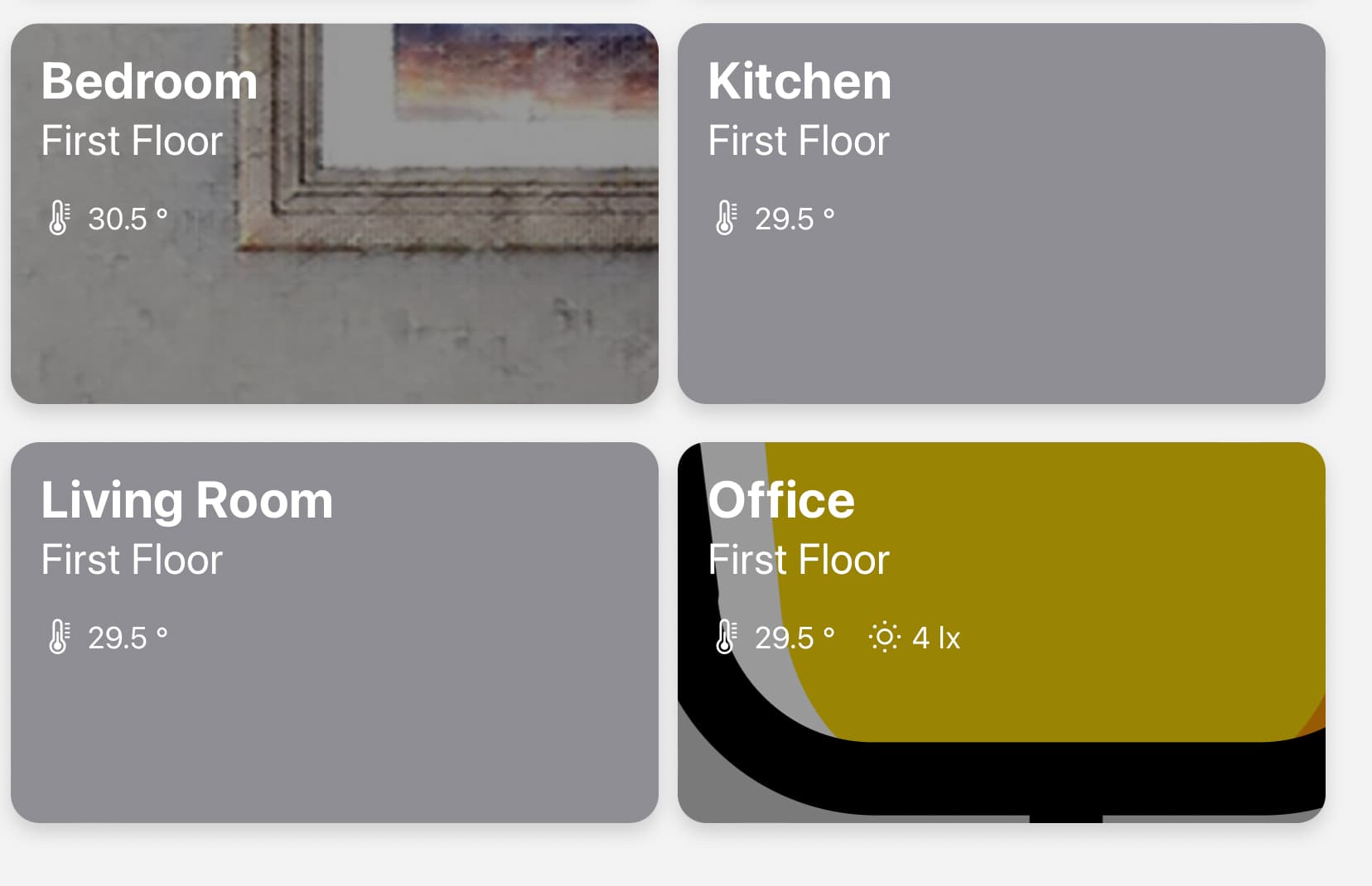

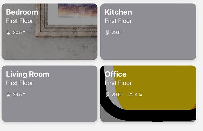

Yup, I am also interested in the answer. My own shots also appear misaligned.
Edit: I reverse engineered a little bit what I could see from the developer console. If you want to be pixel perfect then use the drawing below.
I recommend using higher resolutions which are a multiple of 670 x 200 for nice looking results. like 1340 x 400.
