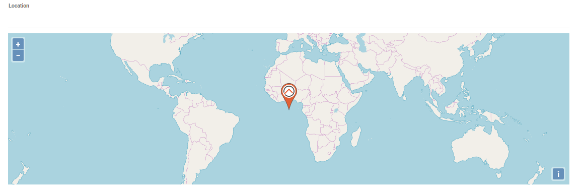

Observations about the “location” parameters and how they interact with the PaperUI when configuring things. I’d appreciate any feedback if you have experience with this.
- It appears that the
descriptionattribute provided in the thing-types.xml file is never displayed:
<parameter name="location" type="text" required="true">
<context>location</context>
<description>The latitude, longitude and optionally altitude, separated by commas (lat,long,[alt])</description>
</parameter>
- After entering a value, if the value is cleared, the map disappears instead of returning to the original default view
