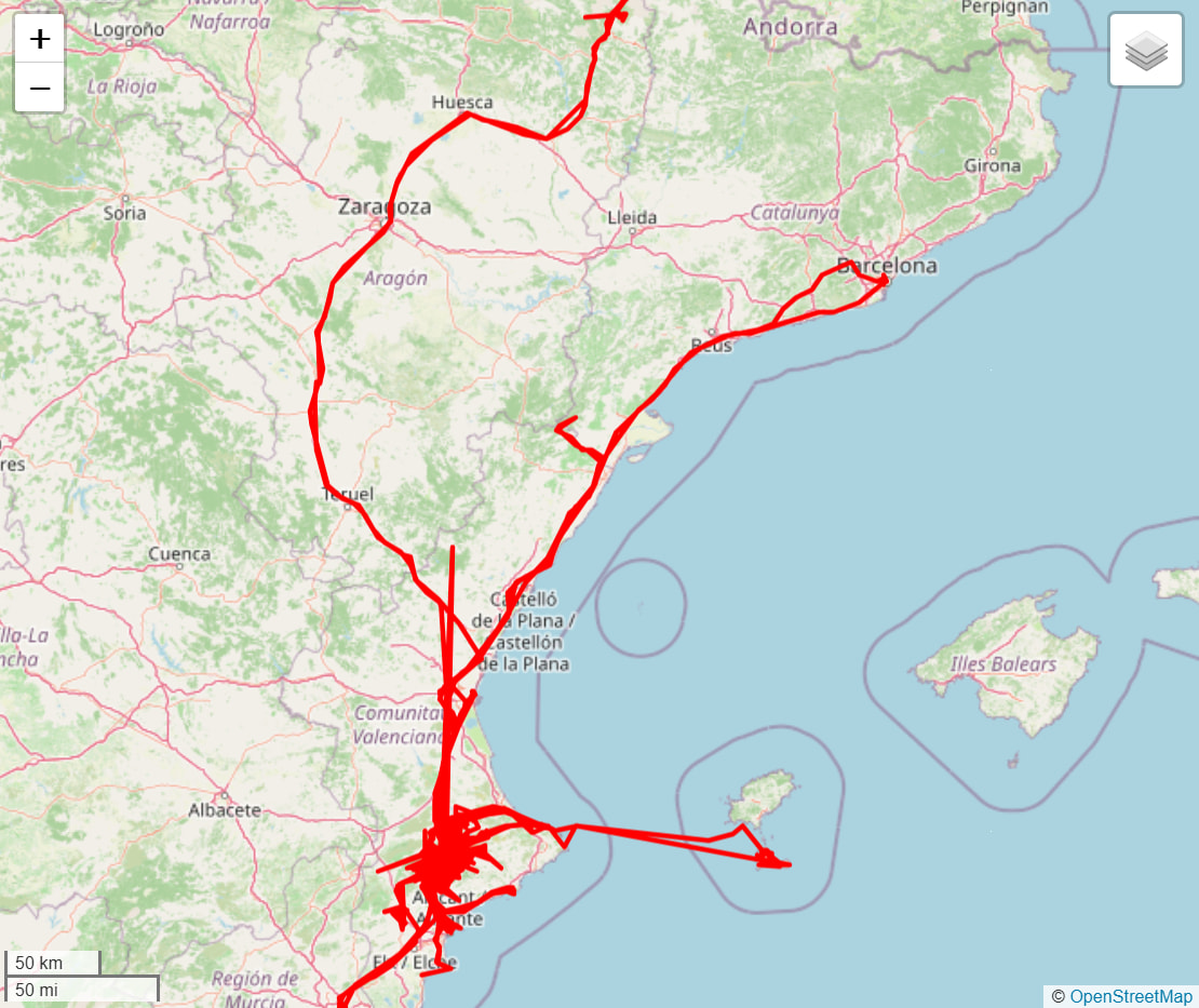

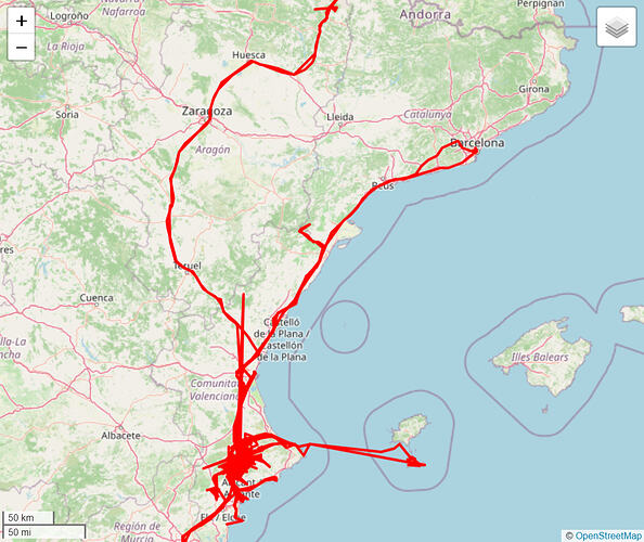

I use something like that, using exactly Owntracks with GPSTracker Binding to record locations store in InlfuxDB and draw with Grafana on the map. Initially I also use that to know when some of the family are at home or not, but I have done this for experimentation and is not bad.
But is not the same as you show, because the locations are reported no so quickly to avoid waste phone battery. Other drawback is due security of Android, you need to start manually OwnTracks after phone reboot to allow them to track your locations. Is not permited on Android to start location services in background without user intervention from some Android version.
That is for example previous year movements recorded:
