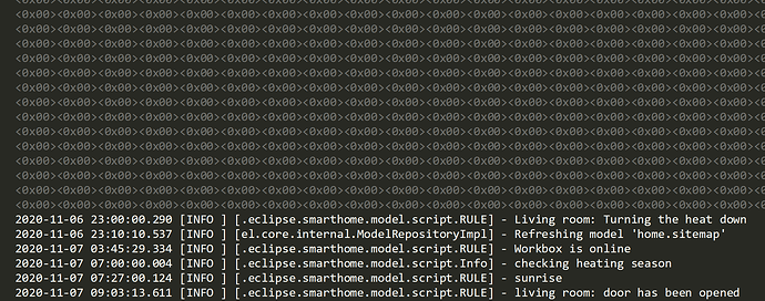

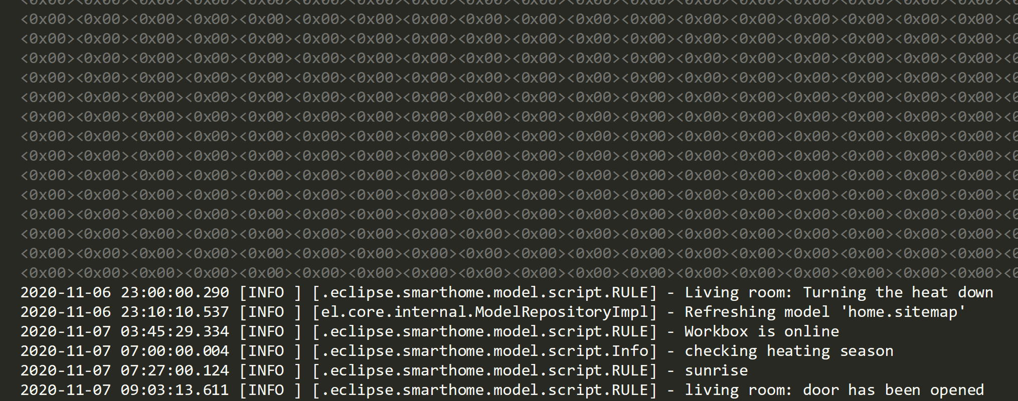

Optik
(Michel)
November 7, 2020, 1:29pm
8
Hi Kees. Have you found a solution to this? Having the same issue (openhab 2.5.10 on odroid n2+ with current Armbian Buster).
