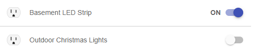

  • Issue of the topic: I can see the item state change in the log but it’s not showing on the Basic UI or Phone App. Here is the Log View
  2020-11-17 13:32:51.457 [ome.event.ItemCommandEvent] - Item 'ESP_26DD63' received command ON
2020-11-17 13:32:51.563 [vent.ItemStateChangedEvent] - ESP_26DD63 changed from OFF to ON
2020-11-17 13:32:51.775 [vent.ItemStateChangedEvent] - mqtt_topic_ESP_26DD63_ESP_26DD63 changed from OFF to ON
2020-11-17 13:35:57.420 [ome.event.ItemCommandEvent] - Item 'ESP_26DD63' received command OFF
2020-11-17 13:35:57.475 [vent.ItemStateChangedEvent] - ESP_26DD63 changed from ON to OFF
2020-11-17 13:35:57.673 [vent.ItemStateChangedEvent] - mqtt_topic_ESP_26DD63_ESP_26DD63 changed from ON to OFF
Here is what the Basic UI is showing.
  • Items configuration related to the issue here are both items.

I apologize if this is a stupid question but I can’t figure out why one is working but the other isn’t and they are both setup the same.
Is it about the missing word ON or OFF for the Outdoor Christmas Lights? Then please set the label to
"Outdoor Christmas Lights [%s]"
Yep that fixed it thanks Udo.
Now I’m just curious why it’s working on all my other light switch items and they don’t have that.
Ha, that’s openHAB mystery :wink:
Well, of course not… it’s all about how the channels are defined. Which addon is used and so on…
