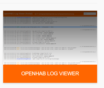

Can you show us what you mean by log viewer?
The log viewer on the openhab2 landing page
That looks like the Frontail log viewer that can be installed as part of openHABian, not openHAB. OPenHAB itself has no log viewer.

Is there anyway to remove the link from the landing page?
Try installing openHABian on the NUC following the link above. It uses the apt repos for openHAB anyway.
If you are not using Zulu Java it may want to change that.
You could always install and configure Frontail if you didn’t want to run openHABian on the Ubuntu as Bruce suggests (it should work).
But if you just want to remove it from the dashboard, you can find an entry in /etc/openhab2/services/dashboard.cfg. It should be pretty obvious which entries to remove. I don’t have an openHABian with Frontail so I can’t tell you exactly. There should be three entries for the log viewer.

You copied an openHABian backup into openHAB. They are 2 different products. You had frontail installed on openHABian but is is not installed on the NUC.
