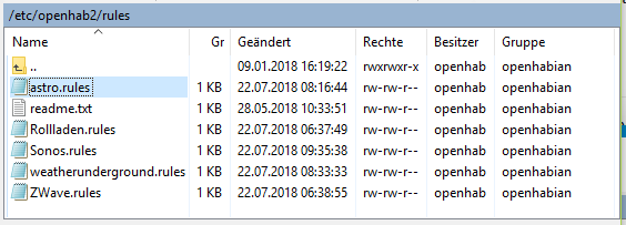

For testing I created different rule-files.
Every rule-file contains a similar rule that sends a log info when system is started.
For example the content of Sonos.rules looks like this:
rule "rSonos_SystemStarted"
            System started
                logInfo("Sonos","***************** System started! Sonos-Logging activ.")
or Rollladen.rules looks like this:
rule "rRollladen_SystemStarted"
            System started
                logInfo("Rollladen","***************** System started! Rollladen-Logging activ.")

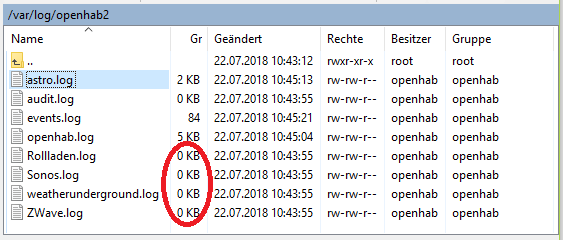

As told before the problem is: When system starts, all log information is sent to the same log file instead of the log file it belongs to. All of my other own log files are empty!
Content of astro.log is:
22-Jul-2018 10:44:52.079 [INFO ] [org.eclipse.smarthome.model.script.Sonos          ] - ***************** System started! Sonos-Logging is activ.
22-Jul-2018 10:44:52.104 [INFO ] [org.eclipse.smarthome.model.script.Rollladen      ] - ***************** System started! Rollladen-Logging activ.
22-Jul-2018 10:44:52.090 [INFO ] [org.eclipse.smarthome.model.script.astro          ] - ***************** System started! Astro-Logging activ.
22-Jul-2018 10:44:52.135 [INFO ] [org.eclipse.smarthome.model.script.ZWave          ] - ***************** System started! ZWave-Logging activ.
22-Jul-2018 10:44:52.139 [INFO ] [.eclipse.smarthome.model.script.weatherunderground] - ***************** System started! Weatherunderground-Logging activ

Yup… it’s wrong :slight_smile:
For each Custom Logger, you need to use a unique name
If you want to log your own logInfo stuff, then use:
log4j2.logger.Sonos.name = org.eclipse.smarthome.model.script.Sonos
If you want to log the output from a Binding, use it’s Symbolic name:
log4j2.logger.ZWave.name = org.openhab.binding.zwave
log4j2.logger.astro.name = org.eclipse.smarthome.binding.astro
you can find the Symbolic names using the console command: bundle:list -s
