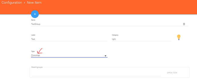

I have been trying to search, but i cannot find a concise answer to how groups work.
This is what i expect, it may be wrong:
I put dimmers in a group. Then the group should show in the control page in paperui, and i can dim both dimmers at the same time.
In my head, the meaning of group, is to control all elements in group simultaneously. This does not seem to apply.

Unfortunately, my group ā€œHomeā€ does not show in the ā€œcontrolā€ page in paperui. So, i have no way of doing any action towards the group.
The group at this point only has 1 member, but that should not matter.
