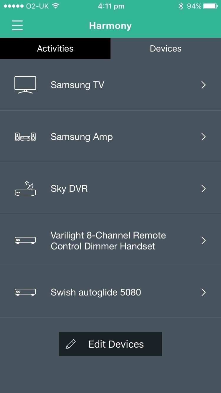

here is the following activities (devices)
please see picture
Just wondering, what is the actual verbiage for volume control on your Samsung Amp device? Is it actually VolumeUp and VolumeDown?
Yes its just Volume up + and Volume down -
