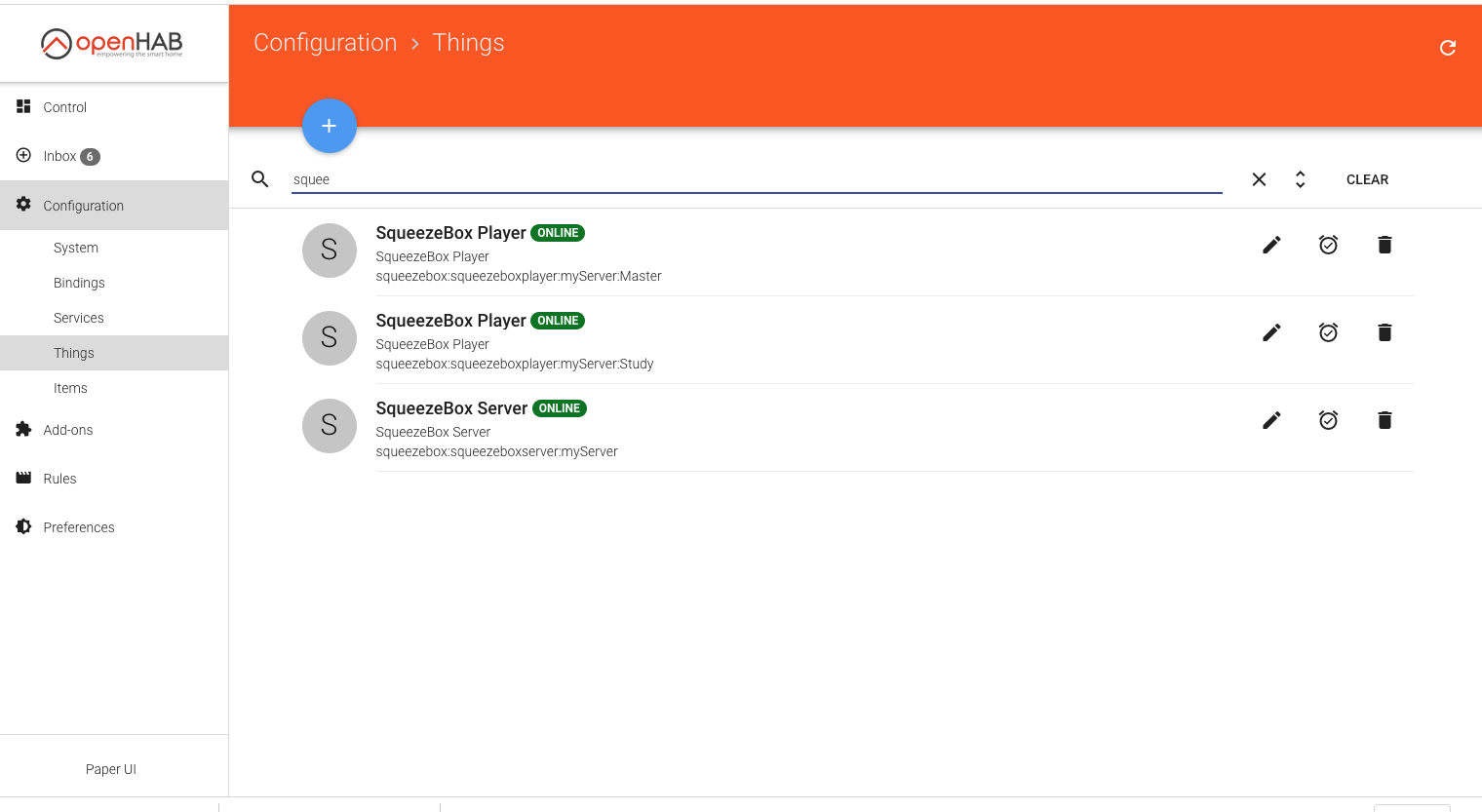

In Paper ui the show online.
Screenshot 2020-04-20 at 13.52.30
But i get the following error in log.

Hi, did you get this working? I’m trying to achieve something similar. What is the “a124a6cb” in you channel? How do you get this?
This should be the thingId of the squeezebox server. Looking a the other files, in my opinion it should be simply myServer.
The items should look similar to this in my opinion:
Switch StudyPower "Power" {channel="squeezebox:squeezeboxplayer:myServer:Study:power"}
