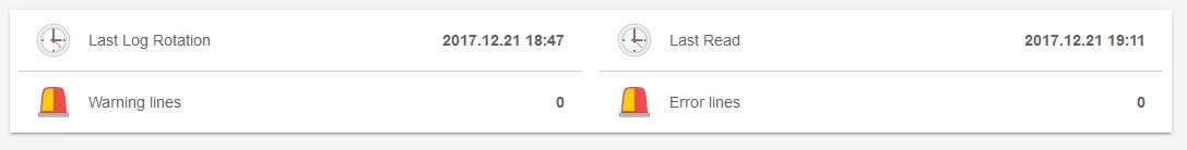

Upps, why does it show “December”???
pi@raspberrypi3:~ $ date
Di 21. Nov 19:21:41 CET 2017
I have no problems with refresh. checked HABDroid, PaperUI and BasicUI.
I’ll do some digging about that month being wrong.
Edit Found the bug. In Java Calendar months start with 0 not 1. Forgot to make the -1. I’ll upload updated binding in a minute.

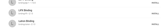

In PaperUI the binding doesn’t show either:
Am I missing something?
Is that screenshot from PaperUI → Addons? That is wrong place.
As you said you dropped the .jar into your addons folder and it shows in karaf. Thats good. Now go to PaperUI → Configuration → Things and click on the “+” button in upper section of the web page. Binding should be listed there.
all right, binding isn’t listed in the Addons > Bindings section, but as you pointed out in the Configuration > Bindings
