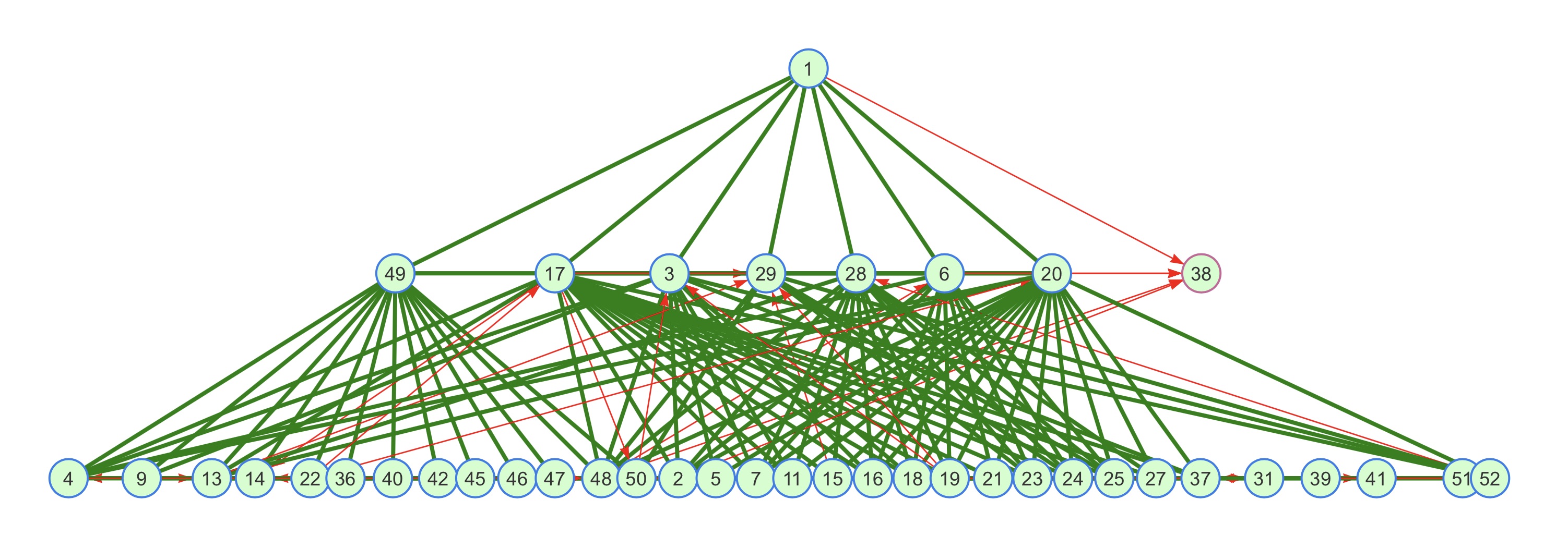

I’m experiencing intermittent problems with my Z-wave network and from time to time some of my lights doesn’t turn on or off as expected. When looking into the log (attached) I can see that the two devices with most problems (#46 and #47) have very long response time - up to 6 sec in the attached log and also time-out and thing-state going offline and then online again. When checking the network status in HABMin, it looks fine - the two devices are communicating with the controller (#1) via a range extender (#49) and also see a few other devices as their neighbors.

Providing a longer log covering network heal and also an updated z-wave map after the nightly heal. I’m not really sure what to do about this and the timeout problems - all ideas are appreciated!
Not really the edge, but some distance from the controller. I have three buildings with devices. The main building with the controller and lots of devices and then two separate buildings (35 and 50 m from the main building) with a cluster of devices in each of them. The device furthest away from the controller is device 51, my electric meter, but it seems to work just fine, providing data about consumption.
I also added three range extenders (one per building) to try to ensure more reliable communication, but I cannot say it really made that much of improvement.
Also, I know that dead nodes can be a problem but I recently used the zensys tool to remove any junk from the usb dongle.

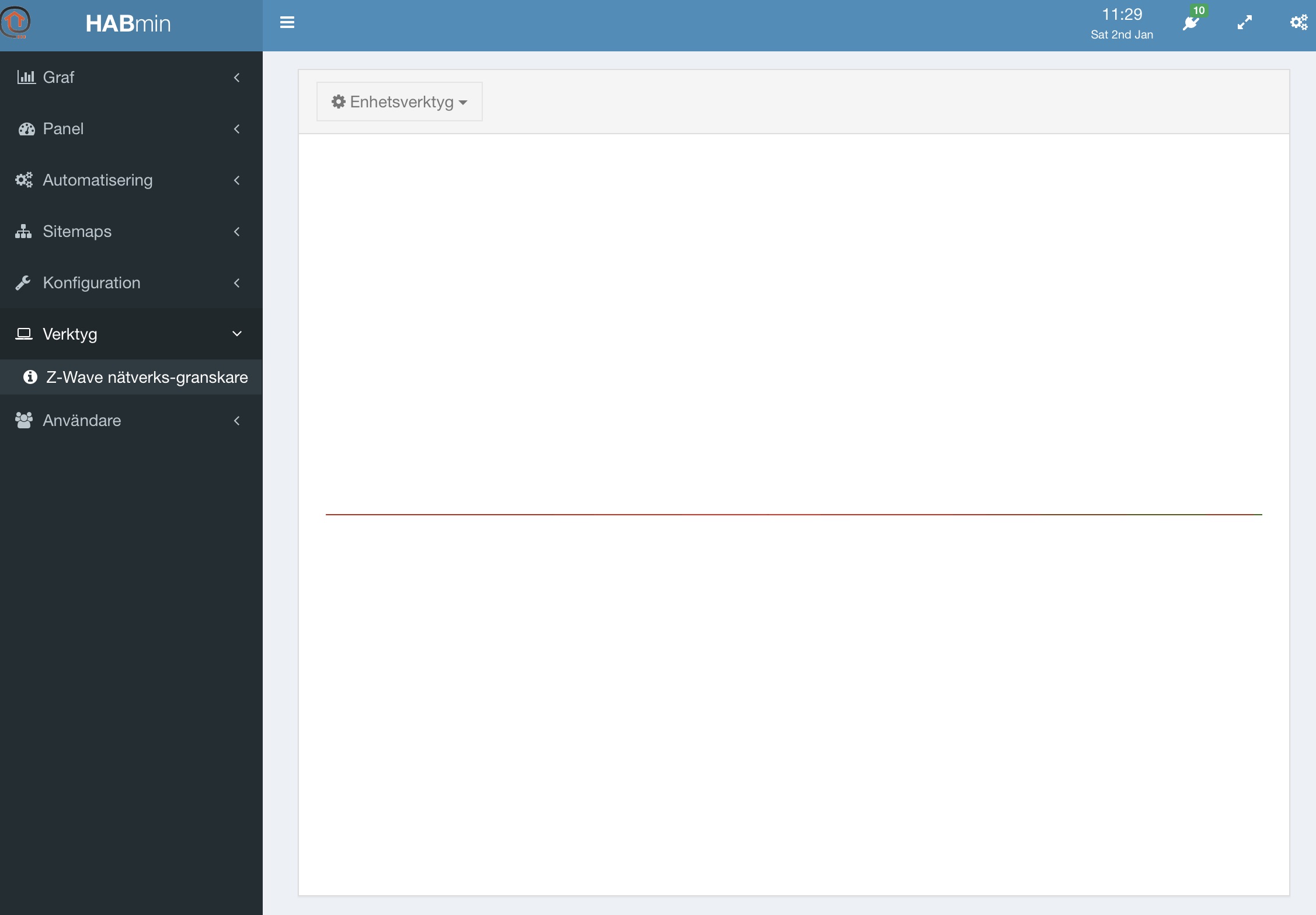

Today’s status after nightly heal. Happens from time to time that the network is presented as just a line. Not really sure why…
