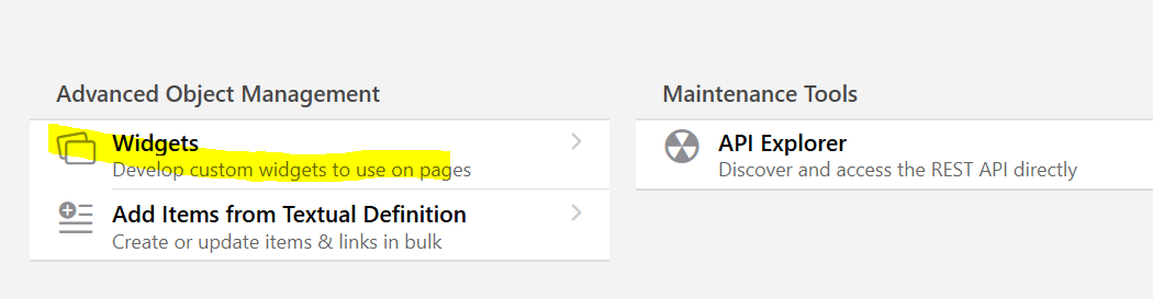

No. you’d have to define that all yourself and once added to the custom overview page it will be fixed.
Since they are already in the Location’s tab, why would you want to copy them? If all you want is the Locations tab you can hide the Overview, Equipment, and Properties tabs I think.
Yes, it looks like you can hide Locations, Equipment, and Properties but not Overview. So you’ll have to create the widgets yourself. You can create the widgets on the location Group Item as the custom “default standalone widget” and then add the location to the overview page from the model.
