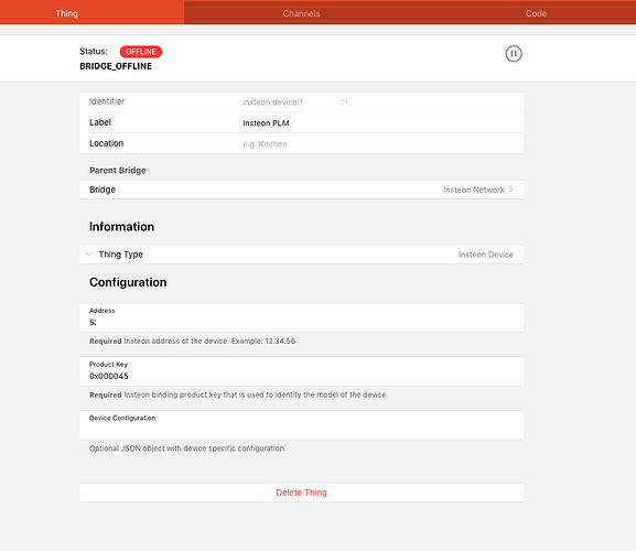

FYI: Status: OFFLINE I plugged the PLM back into the Pi running 2.4
Screen Shot 2021-05-12 at 3.01.47 PM
Your item doesn’t appear to have any tags.

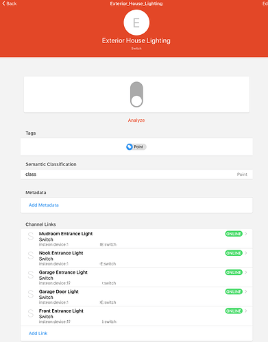

another related question how to I discover a GROUP of switches/lights?
And if I run DISCOVERY again will it make duplicates or just add the new items?
I read the following:
It is important to note that you are exposing Items not Things or Channels.
Only Color, Dimmer, Rollershutter, Switch and Group type Items are supported.
Group type items require the "Huelight" tag to be exposed as devices instead of Groups.
Not sure what to change or where. See screenshot.
