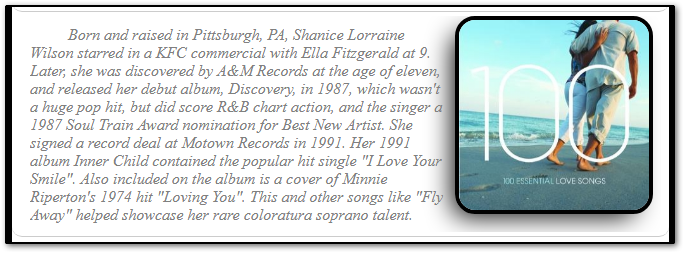

Hi all,
as not all music in my library has cover arts I decided to try to dynamically get the cover image and some artist info for the playing album:
As usual, not an absolute step-by-step tutorial, but an “inspiration” :slight_smile: … will be happy to add additional details if required.
Webview url="/static/Visualization/CoverArt.html" height=6
