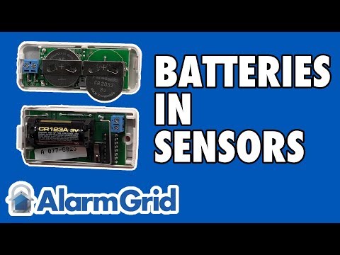

Heres a good chart for the battery for these sensors:
THey last 3-5 years!!
For the above, I am talking about the alarm sensors, such as window contacts, door contacts, PIR motion sensors, garage tilt sensor, glass break sensor, etc. All these can be integrated with the Vista since they are all Honeywell products. I also use AlarmDecoder module. With Alarm Decoder module, you can use ANY of your DIY stuff to trigger the alarm using ā€œVirtual Zonesā€ or Virtual Relays in AlarmDecoder: http://www.alarmdecoder.com/wiki/index.php/Protocol#Zone_Emulation
