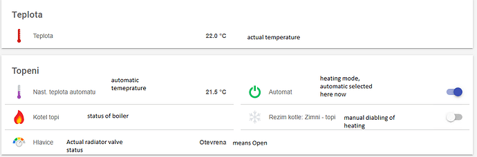

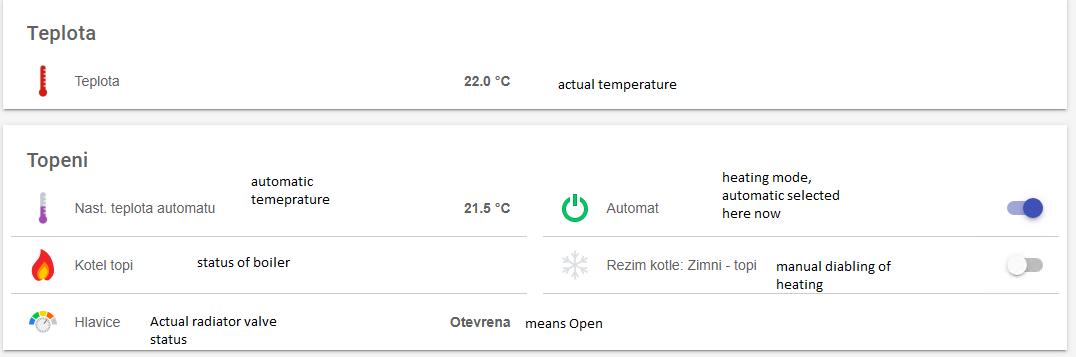

Hi, I actually finished my heating setup by Loxone and OpenHAB. Everything is controlled from OH, because Loxone interface is useless for me. There are two screenshots of LOX config and OH Basic UI. I’m using my CZ language for all objectst, but I made a translation boxes here :slight_smile:
Loxone config:
LOX_topeni
OpenHAB UI:
OH_topeni
Except basic Loxone binding and some rules with UDP sending rules nothing speacial is used. Some fine tuning expected in future, but it’s working and I’m happy. Thanks god for Loxone binding! :slight_smile:
