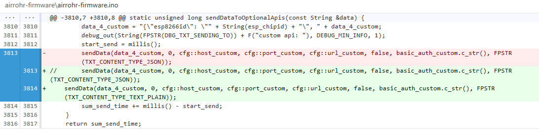

Yes.
I just changed one line for testing purpose
I changed from TXT_CONTENT_TYPE_JSON to TXT_CONTENT_TYPE_TEXT_PLAIN
thats all. But I didn’t find the time to integrate it properly to github. There youl will have to change a few files more, to get also the homepage of the esp correctly set up.
