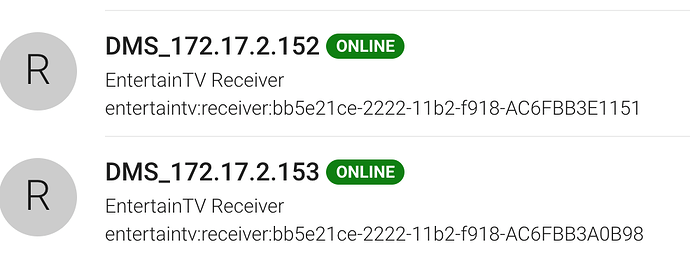

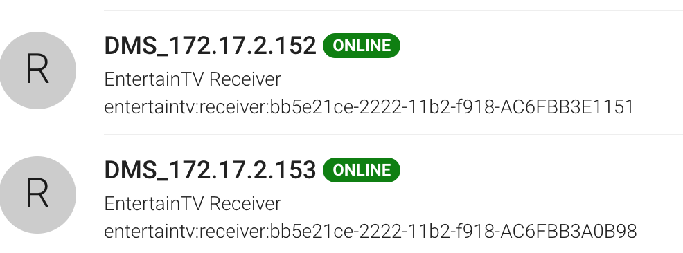

in your “show properties menu” they both have the same name.
Namely dmr_tpb
ok, i see that both report dms_tpr and dmr_tpr
yoi should get a thing
does it get initialized? does the thing gets online?
how does the log look like?

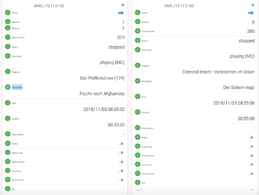

Both are online.
Here is a new LOG.
At the first trace I had activated as desired only the THING of the MR200

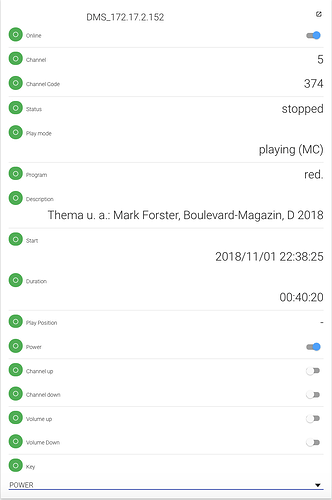

OK. Only the MR200 is online. Have been with the remote control some commands.

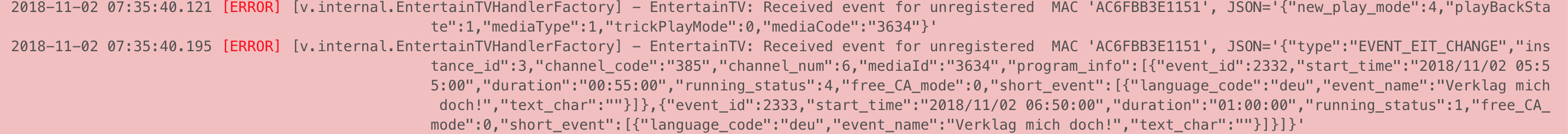

Unfortunately it looks worse now. Now there is no more info in openhab
Please don’t post logs as pictures. Copy them out of the logfile and post them in code fences here.
It is very hard to read your screenshot.
agree
@weralthoff just copy&paste the text information or send me the log as personal message to markus7017
worse is reletive, because now I know what’s getting wrong
  • the discovery reports a unique device id for the MR
  • the pairing response has a unique pairingDeviceID
  • and the event comes in with the MAC address of the receiver
currently the binding compares the MAC with the pairingDeviceID, which doesn’t work and due to a “bug” it always took entry 1 in the device list.
I could fix it by getting the MAC from the UDN (last 12 digits) and us this with the MAC in the event.

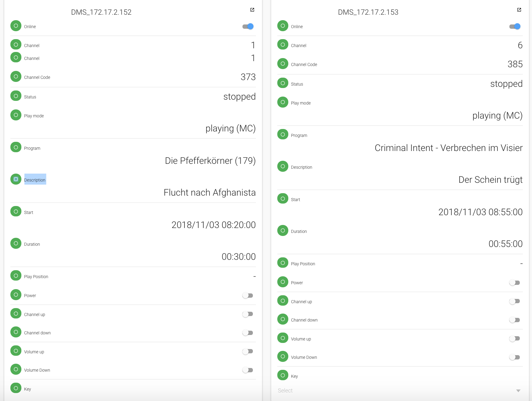

I updated the build and I’m optimistic that this fixes the problem. At least with one MR it worked as expected (correct device lockup back MAC address).
https://github.com/markus7017/org.openhab.binding.entertaintv/blob/beta1/target/org.openhab.binding.entertaintv-2.4.0-SNAPSHOT.jar

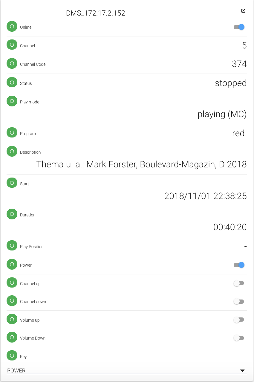

Now only the MR400 active. Now get back info in OH displayed. Can not switch anything.

what I see:
  • pairing works
  • play event works
  • proram event works
as states send-key is not yet working with mr400 and mr200, that’s on the list for next week
MR401 and MR201 should now work including event processing and sending keys
Here to view the current state. Incidentally, I noticed that not the current program info is displayed, but the follow-up broadcast. Currently the 172.17.2.153 shows no current information after a certain time. So about 2 miniutes.
