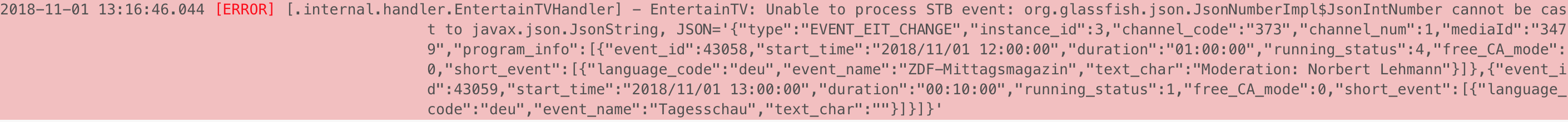

Hallo
What is the problem here.
I can not switch anything.
and the only thing that is displayed is when the recorder is recording a recording.
markus7017
(Markus Michels)
November 1, 2018, 2:45pm
191
that problem will be fixed tonight. depending on the MR model the JSON format is slightly different, MR401:channel_num is a string, MR201: channel num is an int
now Iām checking for string and otherwise use getInt()
which model are you using?

No. When a recording is viewed on the MR200, the Play Info appears on the main unit (MR400).
Otherwise, the error message in the LOG is the same.
