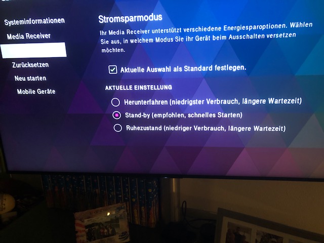

Which Suspend mode do you use?
sorry. what ist Suspend Mode?
“Energiesparmodus” - you colud select one of 3 modes within the menu
I’m testing with Suspend.

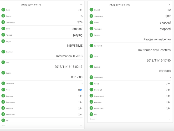

Does someone tested with MR200 or could confirm the behaviour if the POWER switch with the MR400?
The device is in stand by mode, as with you.
Why is that relevant? The device turns on with the command “off”.
so it seems that the 400 doesn‘t send the byebye message. I‘ll add a change that disables this feature for tge 400/200, so you will be back to the old behavior while tge 401/201 use the thing state.
It is noticeable that the ITEM “Online” is missing.
Sorry, wrong Text in the last Post
The MR400 runs parallel to the MR200.
MR200:
The functions are identical.
Also “POWER” only reacts to “OFF”. Again, you can turn on with “OFF”.

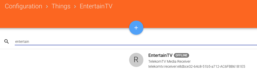

I mean the thing status under PaperUI->Configuration->Things. Open the thing and it should say ONLINE or OFFLINE.
