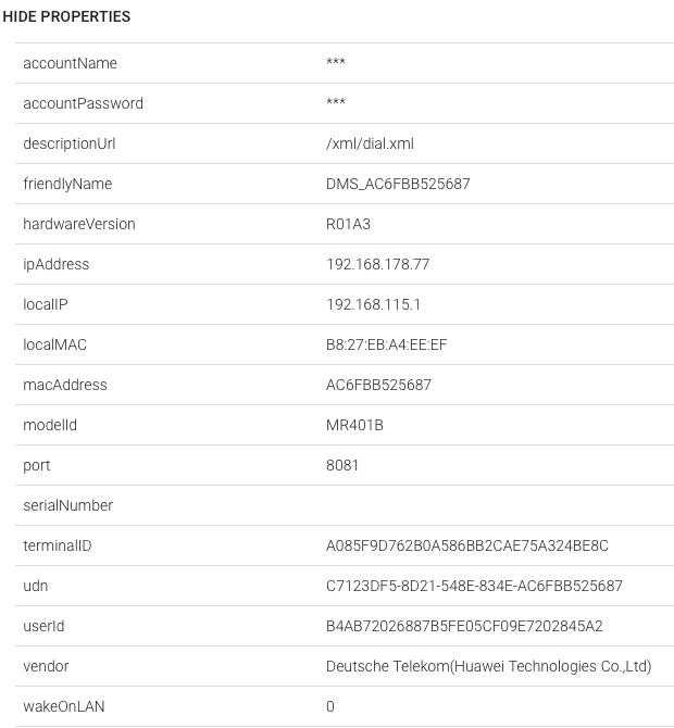

The properties looks good for me:
Could it be the missing serial number?

S/N has no impact on the communication it’s just for information (same as HW version etc.)

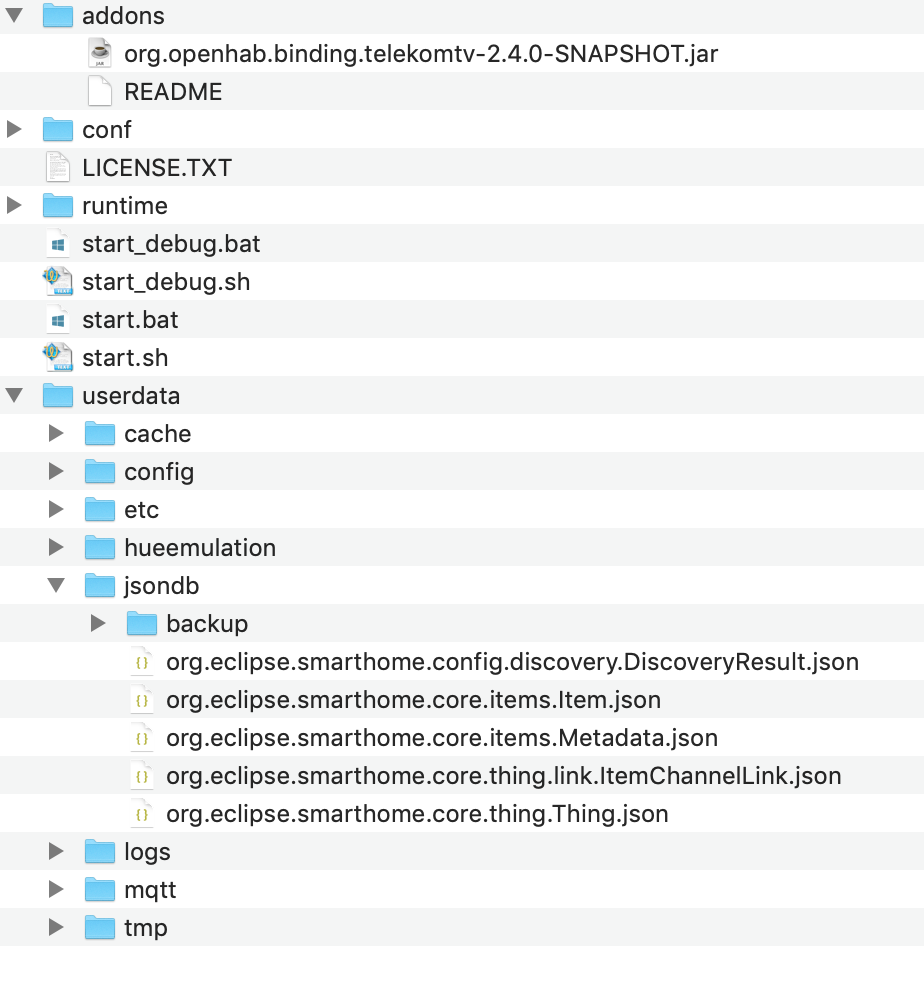

However, I will not let go of the old Binding. Find no entries in the jsondb.
maybe you need to clear the cache
openhab-cli stop
openhab-cli clean-cache
openhab-cli start
