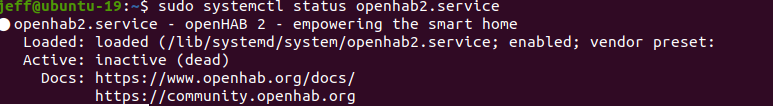

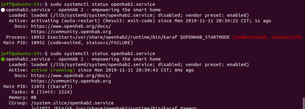

● openhab2.service - openHAB 2 - empowering the smart home
   Loaded: loaded (/lib/systemd/system/openhab2.service; disabled; vendor preset: enabled)
   Active: activating (auto-restart) (Result: exit-code) since Tue 2019-11-12 14:23:09 CST; 3s ago
     Docs: https://www.openhab.org/docs/
           https://community.openhab.org
  Process: 16321 ExecStart=/usr/share/openhab2/runtime/bin/karaf $OPENHAB_STARTMODE (code=exited, status=1/FAILURE)
 Main PID: 16321 (code=exited, status=1/FAILURE)

eff@ubuntu-19:~$ sudo systemctl daemon-reload
jeff@ubuntu-19:~$ systemctl enable openhab2.service
Synchronizing state of openhab2.service with SysV service script with /lib/systemd/systemd-sysv-install.
Executing: /lib/systemd/systemd-sysv-install enable openhab2
jeff@ubuntu-19:~$ sudo systemctl start openhab2.service
jeff@ubuntu-19:~$ systemctl status openhab2.service
   Loaded: loaded (/lib/systemd/system/openhab2.service; enabled; vendor preset: enabled)
   Active: activating (auto-restart) (Result: exit-code) since Tue 2019-11-12 15:40:09 CST; 1s ago
  Process: 6091 ExecStart=/usr/share/openhab2/runtime/bin/karaf $OPENHAB_STARTMODE (code=exited, status=1/FAILURE
 Main PID: 6091 (code=exited, status=1/FAILURE)
