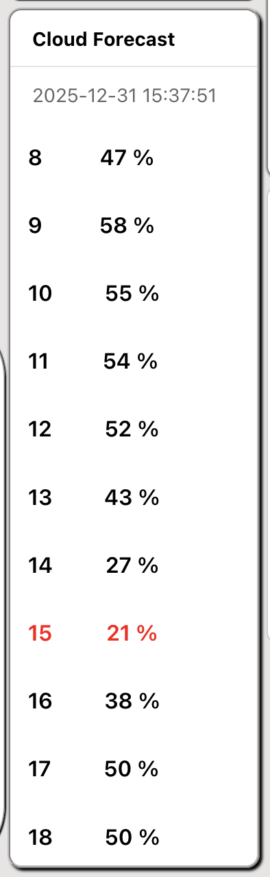

I have an issue i never noticed before and it appears on all three releases

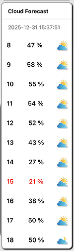

i have a custom widget that display cloud and uses custom icons
if I view the page using http (port 8080 the icons display) but if I change to https(port 8443) then the icons do not display
All i do is change the protocol http/https and the port 8080/8443 using the same url otherwise

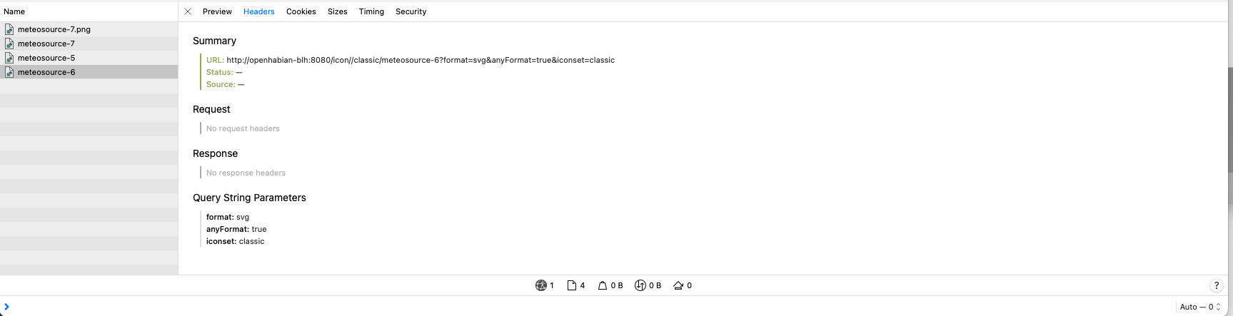

Hi Florian
Apologies - i did not even know much about those but learnt a ton just looking at things - thanks for that.

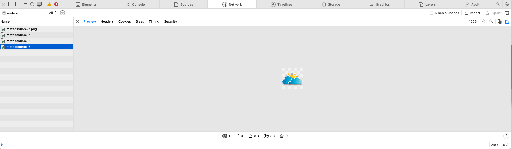

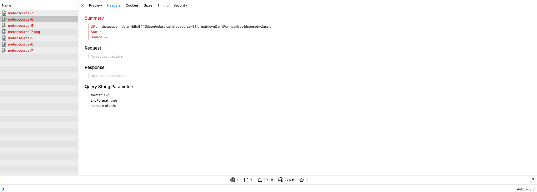

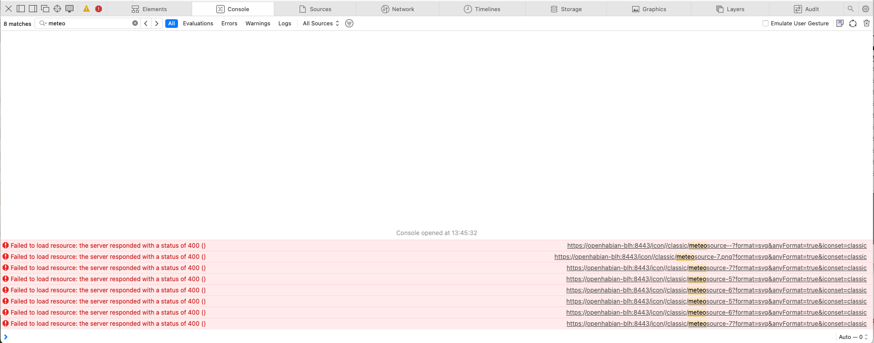

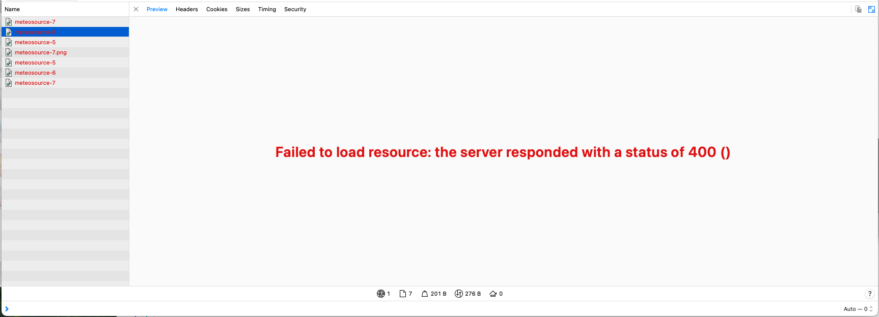

I will do some more digging now that I know where to look but the first thing I can report back is on the HTTPS side of things those icons get a 400 from the openHAB webserver
I filtered on those to limit the data - strange how there icons just do not appear in https:

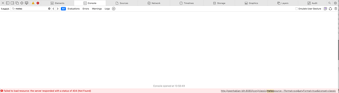

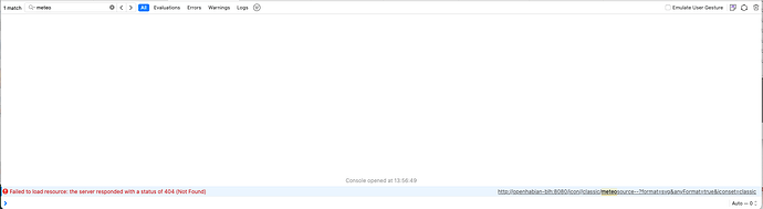

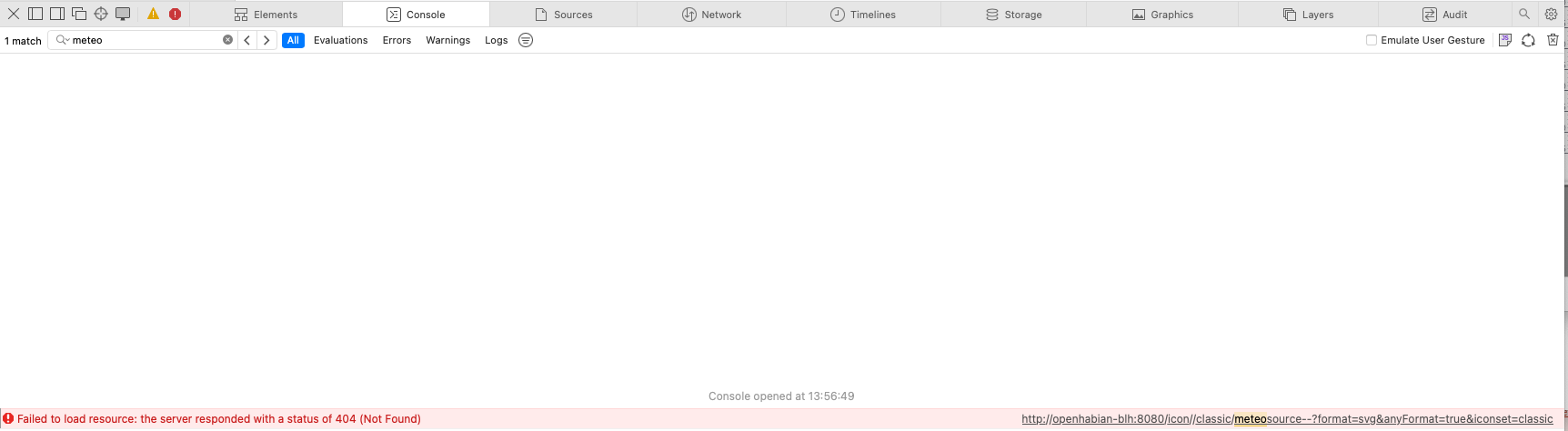

There is one error on the HTTP Side but i looking at the naming it could be an Error i have in my widget text - this i will confirm (last Screenshot) this same error appears in the https (the first one ) I will have a look at my widget and confirm / fix if it is in the widget coding)

I have tested with a direct ip address instead of the name (since the name will also resolve to a tailscale address ) –> the local IP shows the same error
I see that I have a // in the URL and perhaps that is causing the 400 on the https side - i will amend the Widget and report back
Hi Florian
The double // was indeed causing the issue on the HTTPS Side seems the http (insecure) is more tolerant.
I have a /classic/meteosource-6 and now have classic/meteosource-6 so I assume that the server url has a trailing “/”
