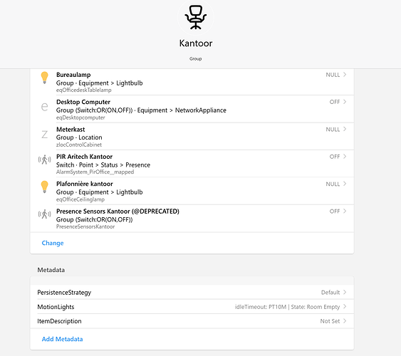

If I change and save a personal module, all the details of my openHAB semantic locations are gone. And the rules that depend on those fail to execute obviously. Than I have to restart the openhab.service and the locations are ok and the rules continue to run.
I’m totally lost now…
My testing is only performed against the current snapshot, but IIRC this fix was backported to 5.0.2x.
Where do the details come from? Are they added via script?
I’ll try to eleborate a bit. I have a personal module that implements a statemachine for lighting. It uses a second personal module that has some general logging functions. When I start openHab, the location items show as this (example):
The MetaData item “MotionLights” is set by the personal module.
Than I change my module on disk (just adding a space at the first position and save the file), the log shows me this message when the script that uses the personal module runs:

I think the main issue is that when saving the code somehow the location items aren’t available anymore. (The context closed error).
Could it be that there is something weird happening in the combination metadata / cache (for timers) that isn’t reloaded correctly after saving?
The most interesting part of the code is the one about writing to the metadata, so what is written and how. This way I can start reproducing and try to understand what’s happening.
I think you are right about the metadata, thanks for the hint. I think somewhere a reference to an object is stored and that the object is lost after saving/reloading the module. If I remove the namespace-metadata from all locations, the location is visible again and the module functions correctly. Probably there is a reference to a non-existing object somewhere?
Now to find how this is possible…I’ve tried to refactor my code in such a way that only copies of objects are stored, this helps a little bit (ie. not all locations are affected but just one) but still I get the error “Script execution of rule with UID ‘motion_lights_statemachine’ failed: java.lang.IllegalStateException: The Context is already closed.”

The code that is responsible for manipulating the location metadata is:

I think I’ve found the culprit :smiley:
I was storing the ‘mlmstate’ as an object into the metadata. If I stringify the object and store it as a string, everything works as expected. Now I can sleep again :slight_smile:
