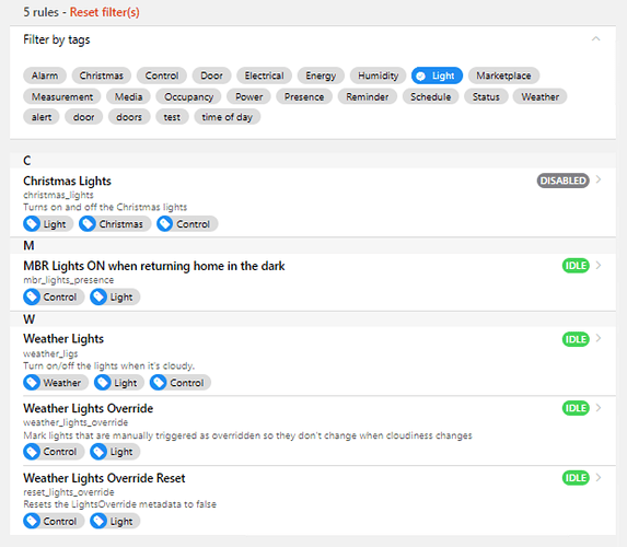

The search field on both the rules page and the developer sidebar will search all of the above. Furthermore, I think OH 4.2 introduces a “filter by tags” option to the rules page so you can just see those rules with a given tag.

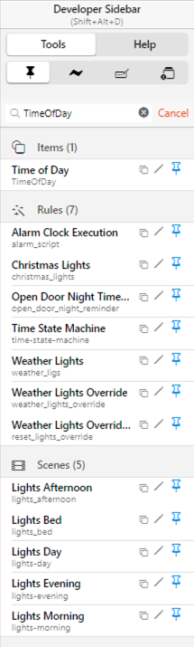

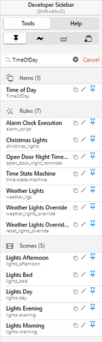

Assuming the pages, rules, groups, Things, and transformations mention the Item by name. The search looks at the name/UID, label, description, tags, and contents of the entity. It does not follow Links, Group memberships, or stuff like that. It’s not going to find stuff that references that Item indirectly (e.g. you’re dynamically generating the Item name in a Rule or a widget). It’s not going to find it in places where the Item is otherwise dynamically used (e.g. Overview tabs, repeater widgets).
It’s just a text based search.
For example, if I search for my TimeOfDay Item I get the Item, the seven rules that use it and the five scenes that use it. Note that in most of these cases (including the Scenes) the Item is used as the trigger.
But lets say I also know that this Item is also included in the Open door reminder rule, but not by name. I can pin the results of this search and then search for the door rule too.

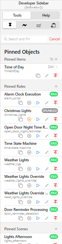

Once I have a good set pinned I hit “cancel” and I’ll get some nice controls on the pinned stuff.
Clicking the pencil on any of these takes me to that entity’s config page. Items with types and semantic tags that allow sending commands (e.g. Setpoint) can be clicked on and commands sent to the Item right from the sidebar. Rules and Things can be enabled/disabled using the pause icon. Rules can be manually run using the play button. And the UID for any of these can be copied to the clipboard with the copy icon.
If you decide you don’t need something pinned anymore, click the pushpin icon again to remove it from the list. To add something to the list, search for it and pin it just like we did when first starting.
