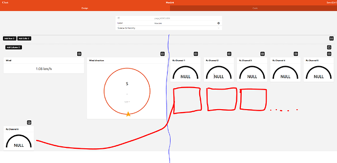

Widgets don’t have a standardized height. Is there a way to create columns and add multiple widgets to that column so it behaves in depended of other columns. This you can fill columns in depended of each other.
Basically, I want to achieve this:
Thanks in advance,
Bastiaan

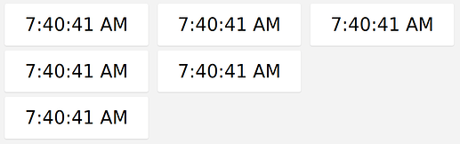

produces these columns:

To go a little bit further, when designing pages such as these, you’ll want to consider how they look on different screens too.
For example, in your screenshot:
You might want the two columns (separated by the blue line) to become a stack when the screen width is below a threshold, to do this you can use the properties on oh-grid-col illustrated here: https://www.openhab.org/docs/ui/layout-pages.html#designing-responsive-layout-pages.
For example the two oh-grid-col components would have width: 100 and medium: 50 properties to achieve that.
Then, while the page designer supports only one level of oh-grid-row / oh-grid-col, you can still reproduce the same behavior within a oh-grid-col in YAML with f7-row / f7-col (the properties are the same).

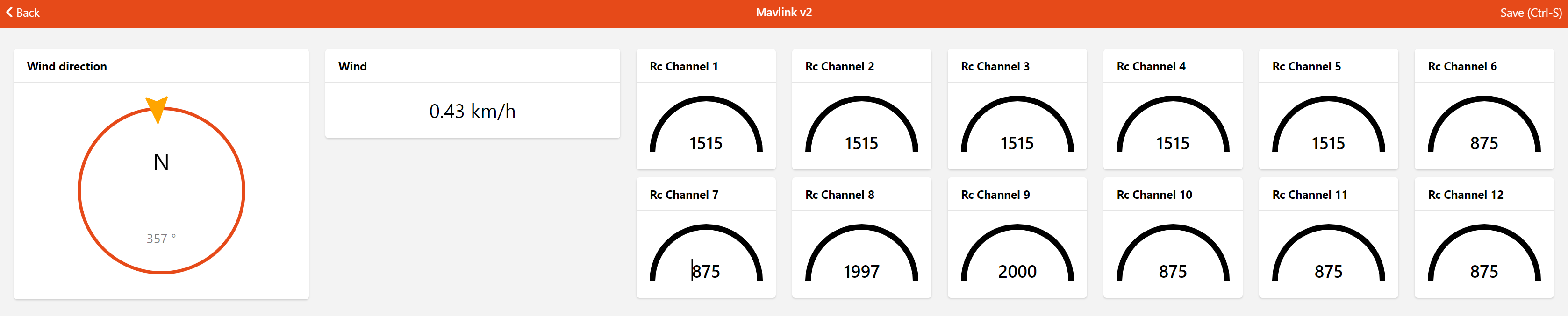

Yes, this works! This gives my the flexibility I was looking for. Thanks!
Regarding the different screen sizes, yes I’m aware of this. That’s the main reason I want to use blocks and not masonry.
