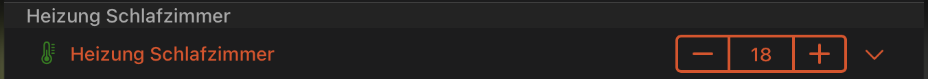

MainUI: How to set custom UI components to default component colors? And how to find these defaults?
Since the default openHAB Main-UI components have trouble with combining a oh-stepper-item with actions or an accordion item(see also this topic), I’m trying my hand at building my own list / accordion item:

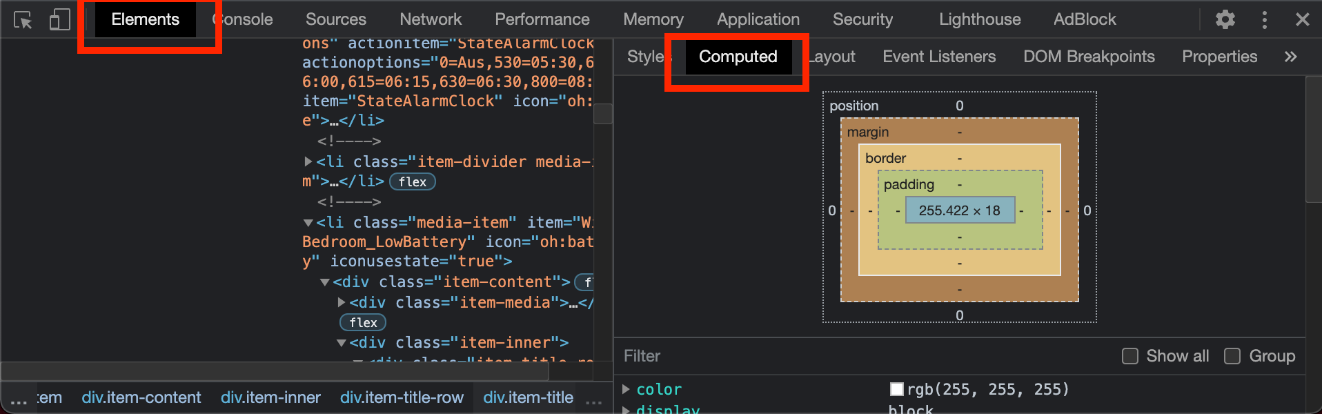

Ok, it seems like one way to find the right CSS variables is to inspect the website* (following examples are for Chrome):
If a certain variable should not work, for example var(--f7-list-item-title-text-color), then just take the one higher up in the hierarchie (in this example try var(--f7-text-color)).

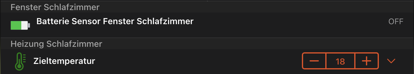

So for the label of my custom widget I can use:
  - component: Label
      text: =props.title
      style:
        color: var(--f7-text-color)
        font-size: var(--f7-list-font-size)
        font-weight: var(--f7-list-index-label-font-weight)
to achieve
That seems to fit.

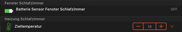

Does anyone have tips how to correct the icon size? That still eludes me… :thinking:
*) Thx @ @AndyMB for this comment: OH3 Standard height and shadow - #4 by AndyMB
No idea why - but font-size: 32px does scale the icon to the correct size, while align-self: flex-start takes care of vertical alignment :thinking:

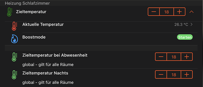

UI:

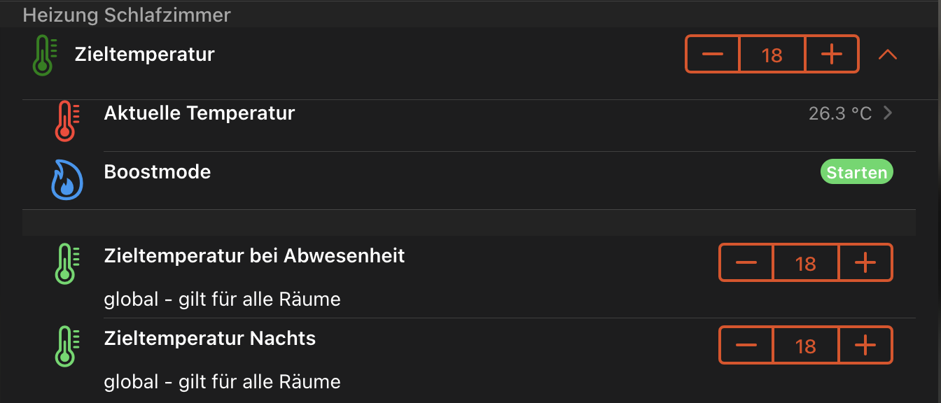

Would think it’s now acceptable, only difference that I still notice is, that the default oh-list-item aligns the label / title higher than centred :thinking:
And when the button next to the stepper is clicked (the down chevron), additional information / controls will become visible:
Code:
