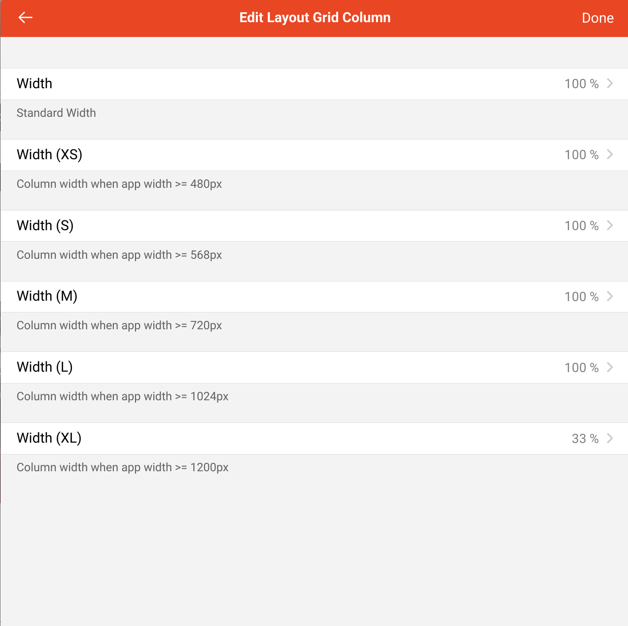

Edit the config for the Column Options and you can set what percentage the column takes up on the given screen sizes.
In the above example, the widget takes up a third of the screen on large screens and 100% on others. So my layout has 1 column of widgets for small screens and three for larger.

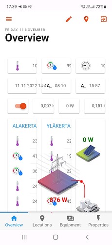

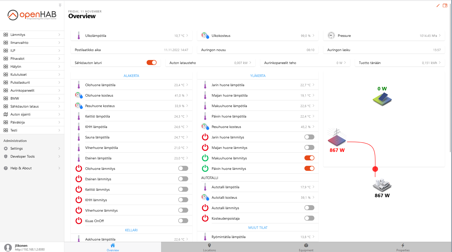

Thanks Rich, I know how to adjust the widths of the column. I’ll show my Overview page which works pretty well on a PC but not on a phone (Samsung S21).
I know the Overview page is just too busy and it won’t work on a phone. I would like to make a simple Overview page for my phone but I’m not sure if this is possible.

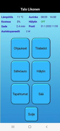

I’m coming from Homeseer world but gradually setting up OH3 (which already works really nicely). Homeseer has developed a graphical software for making nice interfaces for phones. Below is an example of my first HSTouch page with clickable buttons. Each button (when clicked) opens a new page. I didn’t include all the functions in my HSTouch pages but I could control most of the functions at our house.
I guess somewhat similar could be done in HABpanel/sitemaps but at least in case of sitemaps you would need to do lot of coding which I’m not that eager to do. Iin case of HABpanel I would need to create the interface for my phone and Samsung tablet.

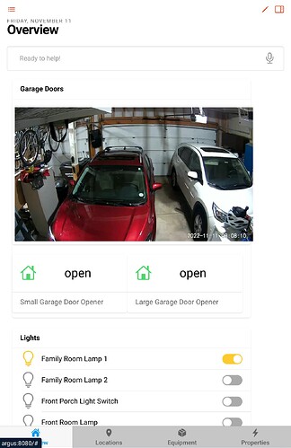

Looking at your screenshot I also think a lot could be done to consolidate a lot of those elements into one widget which will help a whole lot. For example, in the screen shot above, all my lights are in that one lights widget which uses an oh-repeater card to render. So all the light controls stay together and the whole widget gets treated as a unit. That con go a long way towards addressing this.
Also, looking at the screen shot from the phone, you are not using the column properties. The whole point of those properties is to tell the page how many columns to render for small screens. On your phone, there should only be one column. You still have three to four columns per row. That’s why it’s all smooshed together. For anything but the largest screens, each column should take up 100% which will force each to be rendered on a separate row.
Thanks a lot guys. I think I got the message. I need to look at the documentation for the sitemaps again. Perhaps they are not as difficult to implement as I thought.
It seems that I hadn’t setup the column properties for the Overview page at all. I adjusted the widths for each screen size and now my Overview page on the phone looks much better. I’ll need to look at the oh-repeater card. I have used oh-list card in most of my pages.
