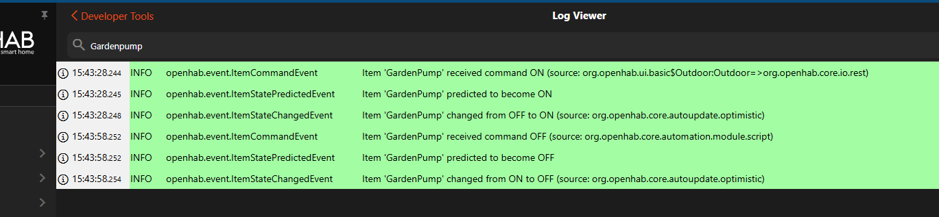

When i switch on my garenpump…
it runs wild. it turn off after a unprecicted time what is not 400s. or not 40s

Thanks to the addition of the source we know that the command is coming from a rule. That makes it clear that the issue is indeed the timer.

Ultimately something is going wrong with the clock in Java. But it’s not clear what that could be.
Add logging to your simple rule. In particularly we want to compare the teimstamp for when the Item changes to ON, when the rule runs (log statement as the first line in the rule), what time the now.plusSeconds(400) ends up becoming, and finally comparing that to when the OFF command is sent from the timer.
