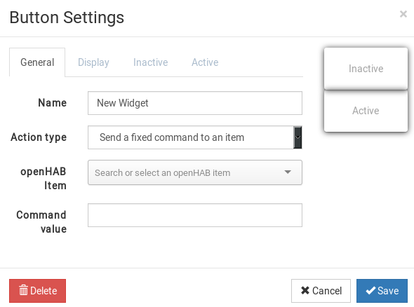

There is already a built-in solution to your problem
Create an item in openHAB
String Dashboard
In the HABpanel setting panel scroll down on the right hand side and find:
Select the Dashboard item you just created
Now in a Dashboard create a button widget and fill in the fields:
openHAB item with the new Dashboard item you just Created
Command value with the name of the Dashboard you want to navigate to
