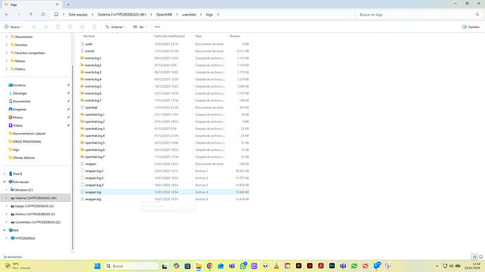

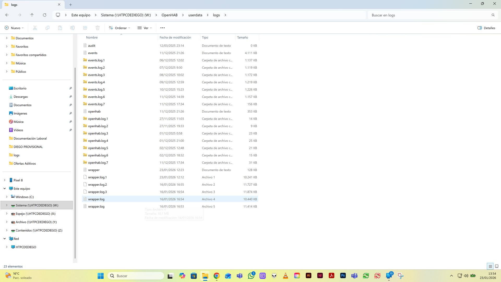

Log files seem freezed since 11/02/25

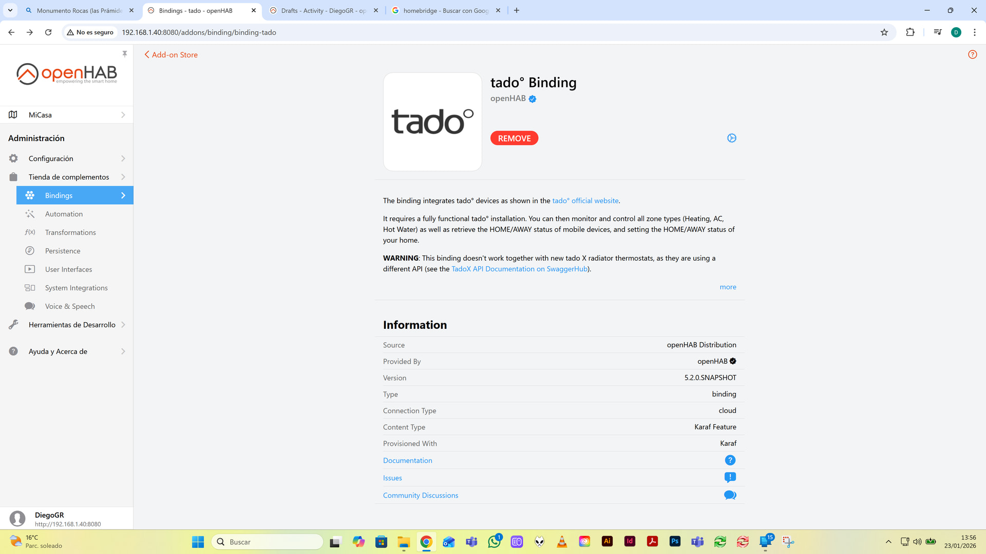

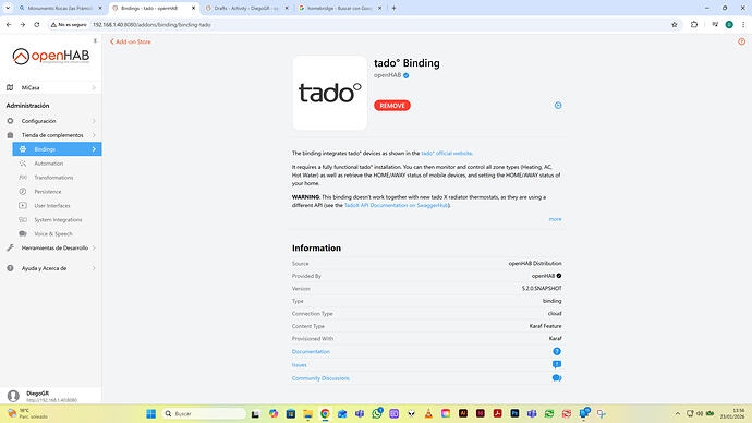

Besides, it is not possible to configure log levels in any binding. Let’s take Tado binding as an example:

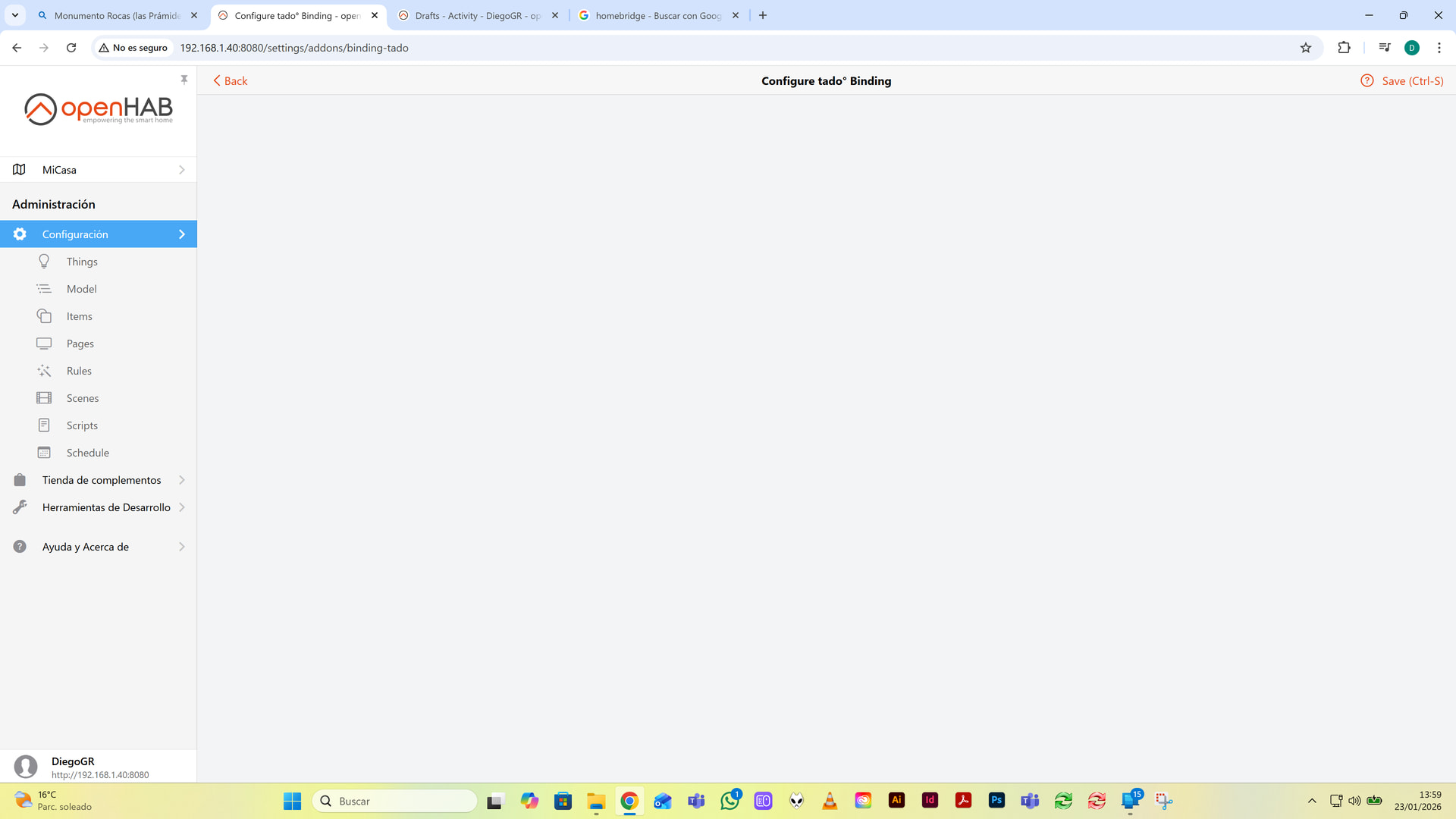

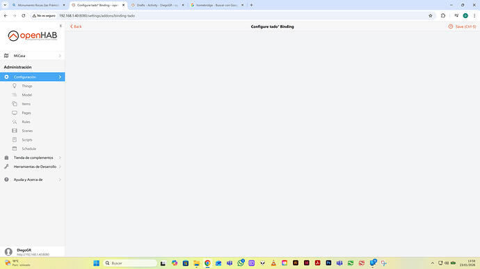

And after clicking onto the blue gear icon placed right at the top (“Configure add on”, nothing happens, and the screen is empty:
