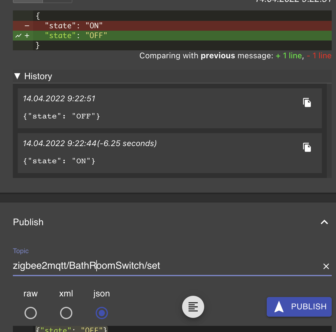

Hello, I need, hopefully, a little help. The problem is that the device does not respond to my commands. Since I’m still quite new to poenhab, then, most likely, I did something wrong somewhere. I am attaching the device configuration to the message. I would really appreciate any help. Thank you!
- Platform information:
- Hardware: RaspberryPi 4
- OS: Ubuntu 20.04
- Java Runtime Environment: openjdk 11.0.14.1
- openHAB version: 3.2
In mqttexplorer everything works
Log: ‘bathRoomSwitchItem’ received command ON (or OFF)
Thing code:
UID: mqtt:topic:b86c3a1d1a:bathRoomRele
label: Выключатель ванная
thingTypeUID: mqtt:topic
configuration: {}
bridgeUID: mqtt:broker:b86c3a1d1a
location: Bathroom
channels:
- id: BathSwitch
channelTypeUID: mqtt:switch
label: Выключатель в ванной
description: ""
configuration:
commandTopic: zigbee2mqtt/BathRoomSwitch/set
formatBeforePublish: '{"state":"%s"}'
stateTopic: zigbee2mqtt/BathRoomSwitch
transformationPattern: JSONPATH:$.state
off: OFF
on: ON
