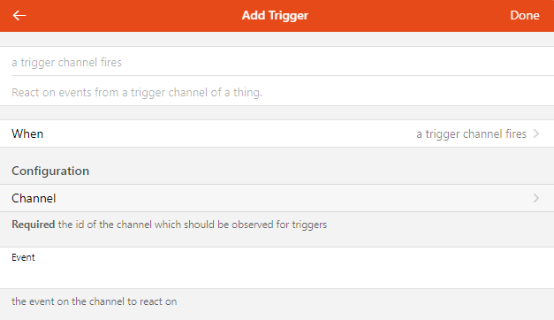

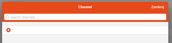

So when I try to choose a Channel for “a trigger channel fires” Add Trigger dialog:
This empty list appears:

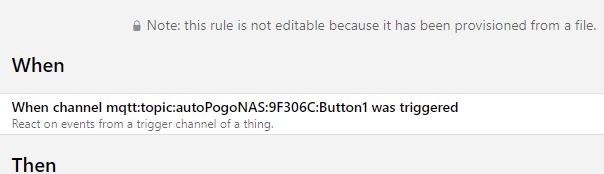

Not only it works but also appears fine in rules UI (just cannot be edited):

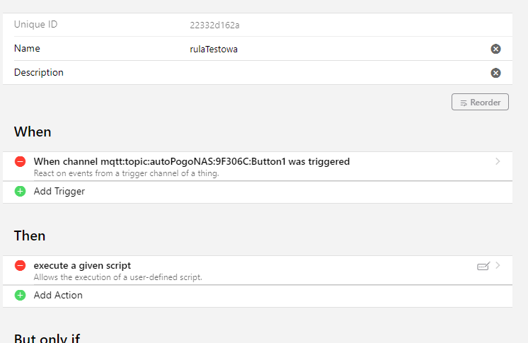

I’m able to achieve expected results in the Design UI:
Which is editable (of course I still cannot pick trigger channel from the list).

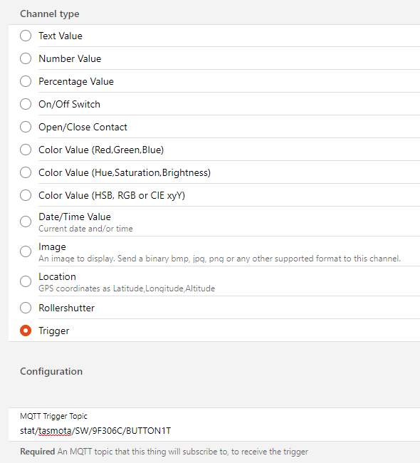

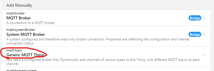

You are right, I have not specified it, sorry for that. I’m creating the Thing with a trigger channel in UI:
And choosing Trigger as a Channel type:

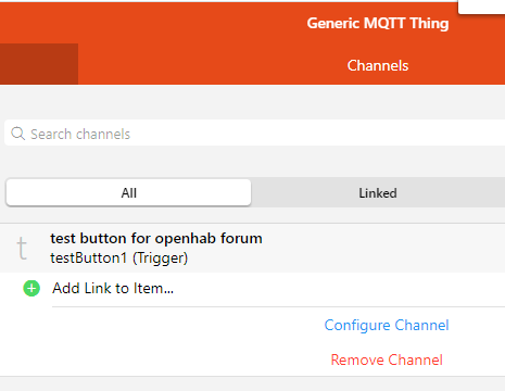

Which results in the following situation:

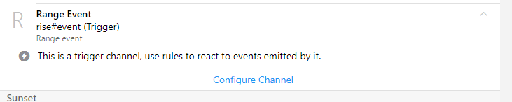

As you can see, already here this is unexpected situation as the trigger channel allows to add a link, which should not be a situation for properly defined trigger, I assume. For example this is an Astro Thing trigger channel in UI (expected behavior):
