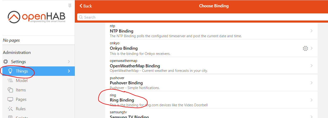

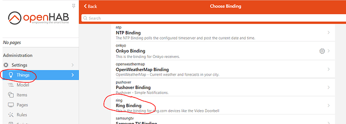

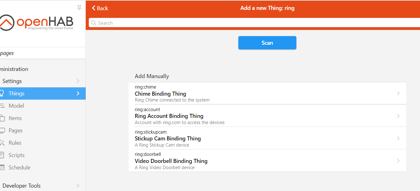

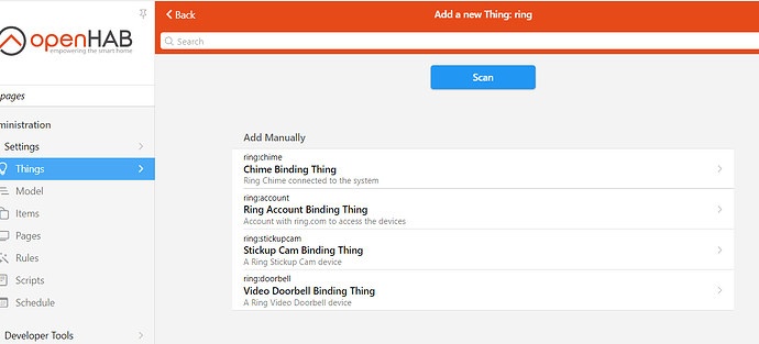

Go to GUI THING, then click + sign in the lower bottom right corner to add a THING. You will NOT see the Ring binding in the GUI binding section when you manually drop it in the add-on’s.

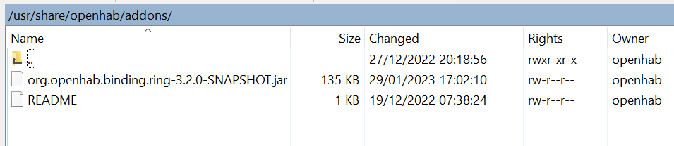

Here’s a pic of my add-on’s directory with the ring binding.

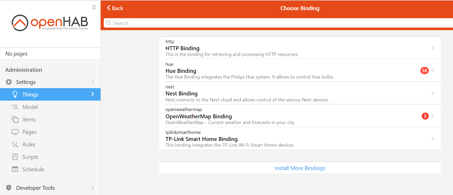

I’m very familiar with how to add Things and Bindings generally, just couldn’t get this manual one to work. When I click to add Things on my instance, the Ring Binding isn’t there:
Another difference from yours is I don’t have the Json Simple Addon that you have (and the original post references) - I’ll add that now and see if that makes a difference.
