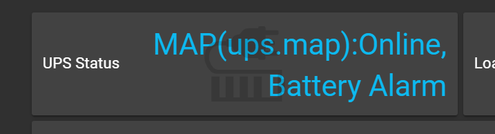

I have been using MAP with HABPanel since 2.2/2.3 and not had any issues with it. Over the weekend I upgraded to 2.5 (and moved from RPi to docker)
I now have this:
The map has worked but HABPanel is also showing the description of the item.
Has anyone else seen this? I’ve removed and readded the binding. Same effect.

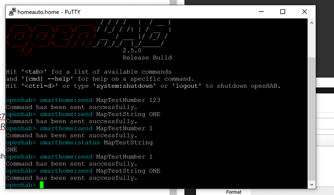

Item:
String MapTestString "Test - [MAP(test.map):%s]"
Number MapTestNumber "Test - [MAP(test.map):%s]"
test.map
1=Value is number one
3=Value is number three
ONE=Value is string one
THREE=Value is string three

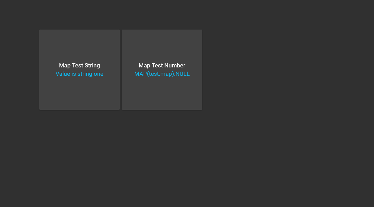

Habpanel:
The above test works. The UPS example has not changed since I first created the panel around a 18 months ago.
Anyone else got this?
C
Well, it seems the default behaviour has changed?
If I untick the “Use Server provided formatting” setting it works as it should.
Pretty sure I have not changed this as part of the upgrade yesterday…

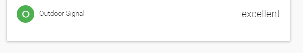

In PaperUI you’ll find it like this:
OH 2.4 shows the translated value
OH 2.5.x shows “raw value”
it’s not a big deal though as PaperUI is not designed as THE UI
