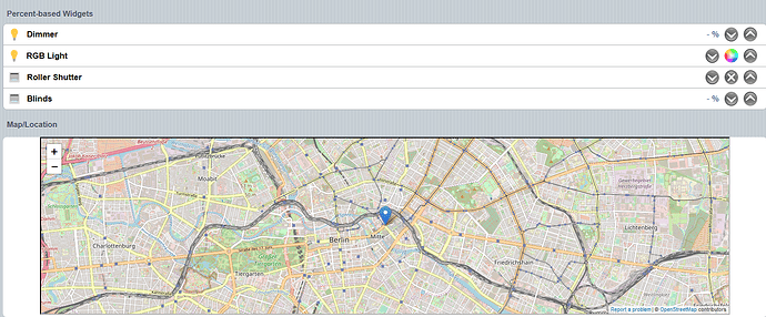

Hi everyone,
Just need bit of advice.
How to setup location on map correctly?
I`m using configuration from demo house for it (sitemap + items).
Its showing default location, how to change it so it updates to my current location. This is what I can see at the moment - Berlin, miles away.
Do I need any additional binding to detect my location?
I`m including configuration below:

Yes you do, how do you itend openHAB to know where you are? Mobile phone, GPS tracker? There are different possibilities

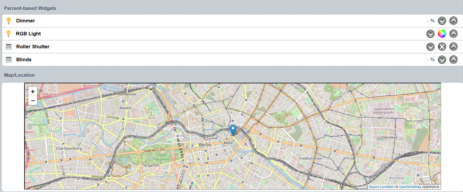

5

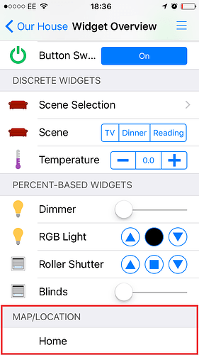

HI Vincent,
Thanks , this works now when accessing OH2 via web browser (Classic UI or Basic UI)

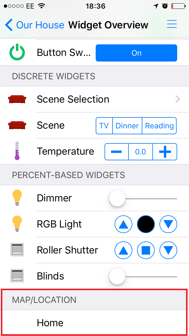

However when I visit the same section on my mobile phone OH2 app location is not shown.
Is there a limitation of the app for mobile phone ? Or do I need to enable something else ?

What mobile do you use?
iPhone or android?
vzorglub
(Vincent Regaud)
8
See:
Time to get a better phone…

Thanks Vincent that’s explains. I probably will get android phone as soon Im out of contract.
