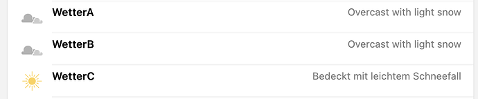

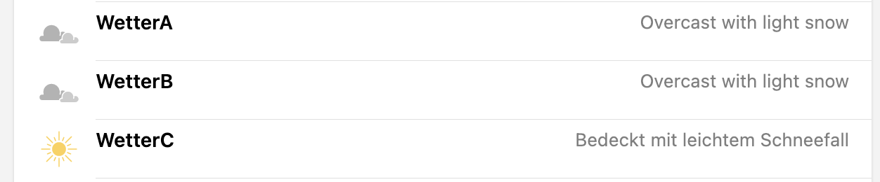

I have problems translating the English text to German of the weaterforcast app Meteoblue for an item using dynamic icons (iday). Either I receive a correct iday icon image but no translation of the accompanying weather sentence or I get the default iday icon image with the accompanying translated text. Here my definitions in the *.item file.
At the “day0CondA” item (“WetterA”) I get the correct icon numbers for iday (1 to 17) and the corresponding English text explaning the weather condition (also is it unclear to me how 2 parameters are attached to an item, the number between 1 and 17 as well as the text “overcast with light snow”. At the “day0CondC” (“WetterC”) my mapping converts the item number to the German text correctly, but the iday icon is not selected anymore as the icon’s state gets the mapped text:
String  day0CondA   "WetterA [%s %%]"   <iday> (WetterTag0) ["Measurement"]             {channel="meteoblue:weather:metBridge:ChaletLauchernalp:forecastToday#condition", listWidget=" " [iconUseState="true"]}
String  day0CondB  "WetterB [MAP(wettertest.map):%s]" <iday> (WetterTag0) ["Measurement"]             {channel="meteoblue:weather:metBridge:ChaletLauchernalp:forecastToday#condition", listWidget=" " [iconUseState="true"]}
String  day0CondC  "WetterC [%s %%]"  <iday> (WetterTag0) ["Measurement"]            {channel="meteoblue:weather:metBridge:ChaletLauchernalp:forecastToday#condition [profile="transform:MAP", function="wetter.map"], listWidget=" " [iconUseState="true"]}
Here a screenshot of the received output in a Page:
Thanks for your help

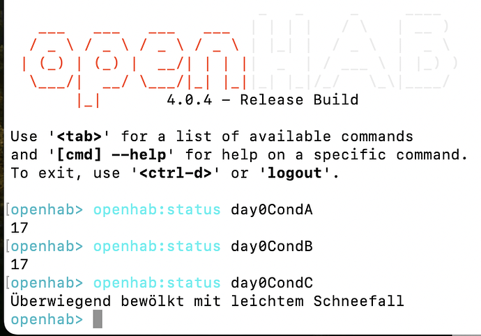

command line screenshot (issued now, so other weather info):

Interesing is that for my test situation “day0CondB” the map function does not work, for all other kind of item I never have encountered a problem at all with this kind of syntax. Due to that reason I tried it with the “transform:MAP” syntax in the channel.
One thing I do not understand is: how does openhab handle the two “values” for the items “day0Cond…” as the status received from meteoblue is a number (1 to 17) and the text shown is a sentence. So we have two values attached to one item: a number and a text sentence (string?). Or do I see something wrong.
