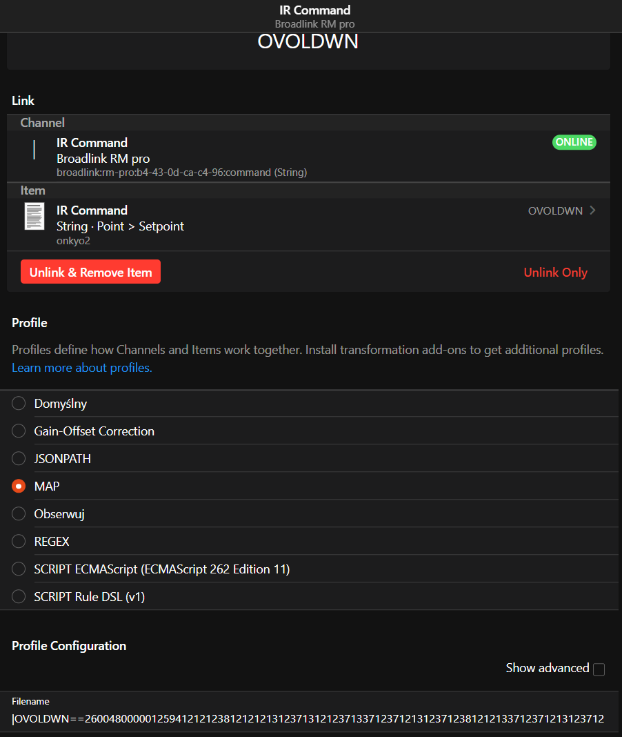

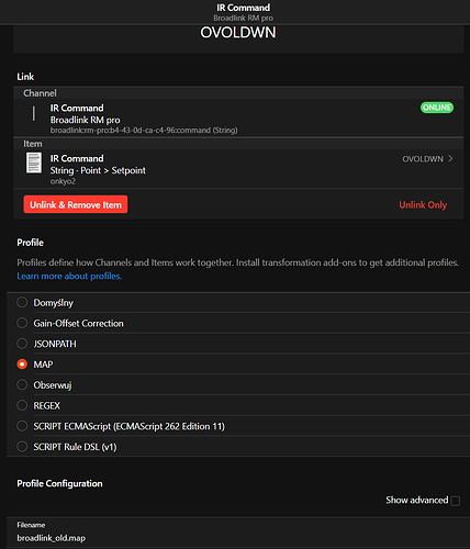

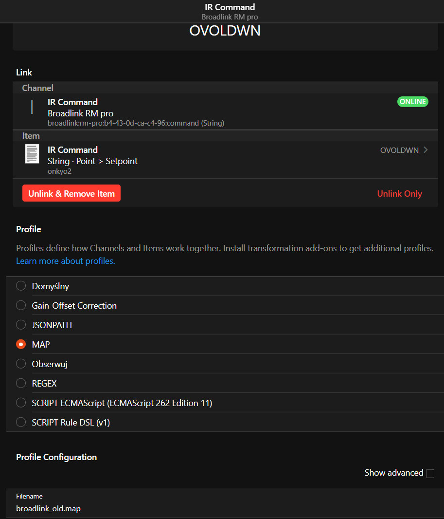

Observation:
in 3.3.0 map file was configured in Thing conf, now is moved to Channel/Link conf

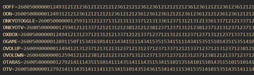

Configuration:
.map file copied from old server (tried also to make new map via UI, but got same error)
Even with inline map I’m getting exactly same error
