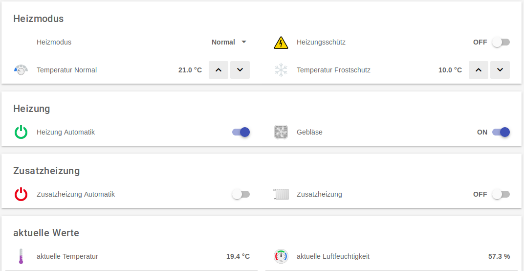

My main problem is, that i didn’t know how to realize this in a optimal way. This is what actually my sitemap looks like:
grafik
In the past days, i’ve added the temperature controlling to the rule:
