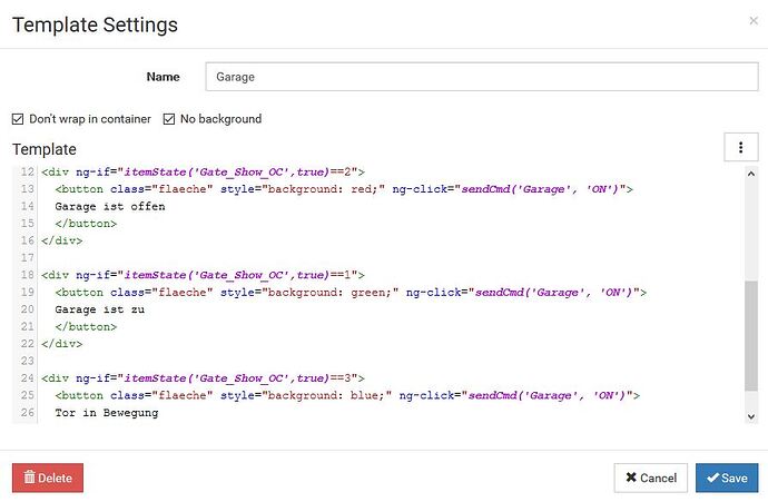

ng-if="itemState('Gate_Show_OC',true)==2"
works fine for me.

I don’t know what to do with this ng-if=“itemState(‘Gate_Show_OC’,true)==2”
where do i put this in ??

I dont know where to put this code ng-if=“itemState(‘Gate_Show_OC’,true)==2”
do I need to put the code in Habpanel or Items or some place else?
In a habpanel template … if you are using that.

My code is not for the standard widgets (dummy, …), but for a template widget.
