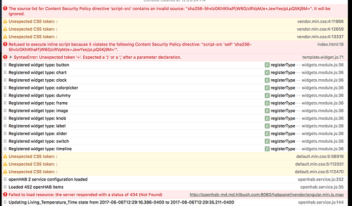

@ysc Here you go. Looks like it’s throwing a number of errors, including template.widget.js
I generated this by doing a refresh of the main HABpanel page.
Edit: Not liking this line of code?
Ah, good catch, this was added recently.
Also I’m a bit worried by the content security policy being ignored…
Thanks! it should be easy to fix.
Cool. Thanks for the quick follow up.
I wonder why it didn’t show up on other platforms. Maybe the old template.widget.js is still in the browser cache?
I wasn’t sure what to make of the Content Security Policy stuff. Glad you know what to do about that. :wink:
Win10, FF Browser, clean cache, habpanel version 2.1.0.201706022154:
Because the ignoreTransform = false syntax is valid on other platforms but not on iPad…

Replaced line 71 in template.widget.js with these 2 lines and it’s working again on my iPad… :+1:
scope.itemState = function(itemname, ignoreTransform) {
    ignoreTransform = (typeof ignoreTransform !== 'undefined') ?  ignoreTransform : false;
