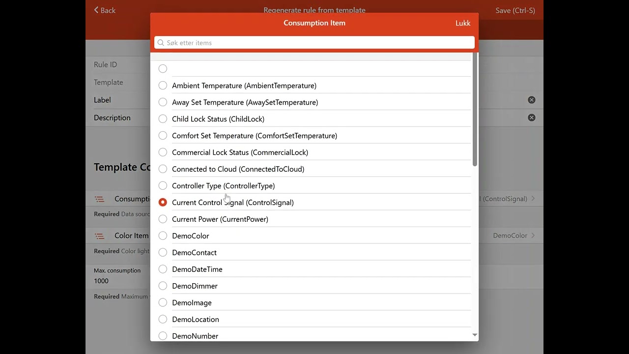

Basic rule regeneration is working. This should work both if the template has been updated or if you just want to modify one or more parameters. I haven’t yet figured out how it can be done for read-only rules (read-only “rule stubs”), and there’s a couple of small things I haven’t made, but otherwise it’s done:

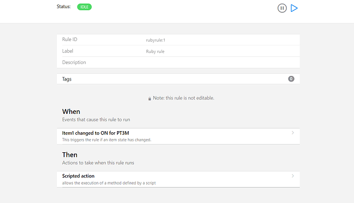

try this ruby script
rule "Ruby rule" do
  changed Item1, to: ON, for: 3.minutes
  only_if { Item3.on? }
  only_every 1.hour
  run do
    logger.info "test"

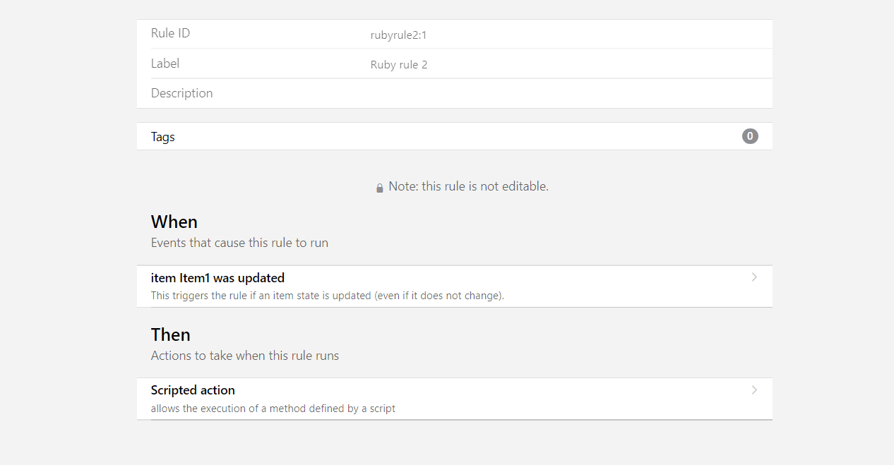

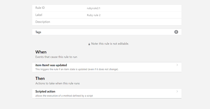

or this:
rule do
  updated Item1, to: 1..2
  run do
    logger.info "Item1 is between 1 and 2"
It the “trigger attachment” described here what you’re thinking of?
Note: The trigger attachment feature is not available for UI rules.
I’m not sure it’s a problem if it doesn’t show in the UI. You can still see it in the “code” tab, and it’s not technically a part of the trigger (if I understand it correctly), it’s just that OH passes an object that allows the ruby code to do additional “evaluation” and potentially “abort” the trigger, or take different actions based on the object. But, fundamentally, the trigger is still just the trigger…?
I would much prefer that file-based ruby scripts just go straight to the script editor like it does now. It’s much quicker to see it that way than having to click-click further.
I know they will show up, but with incomplete information, you’d end up having to click into the script to get the full details anyway. This just adds extra steps.
It’s not difficult to do this for specific MIME types, but I’m not sure if that’s the best way for everybody, also those not that into the syntax of the scripts. Also, it’s just one extra click, when you click the “Scripted action”, you get this:
You’d assume that the person writing the script would be familiar with it.
Yes, as long as you understand the script, it will be one extra click. On the other hand, some information will be available also to those that don’t understand the script.
But, it seems like it is like I assumed: Technically, the trigger is “standard”, but since the object is passed to JRuby, it can do additional evaluation from within the “action” and then reject execution. Still, in the OH log for example, the rule will have been triggered, even if Item1 is outside 1..2.
Yes, but are these scripts only used by people competent at writng them? Is there no copy/paste/“sharing and modifying” going on?
In any case, as I said, it’s easy to do it either way. I’m just not sure what is best on the whole. You’d “lose” the ability to see the rule as it is seen by OH.
