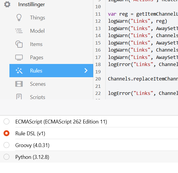

@holger_hees It feels like I’m really close to get GraalPy as well as GraalJS working in Eclipse. It would be very helpful for all kind of testing if it worked. I have actually gotten it working on a Fedora VM, but on my Windows dev computer, it just won’t work.
It doesn’t really produce any real error, no exception or similar, but the log states:
05:26:24.746 [DEBUG] (main                ) [nal.ScriptEngineFactoryBundleTracker] - Modified org.openhab.automation.pythonscripting: STARTING
05:26:24.819 [DEBUG] (main                ) [t.ScriptTransformationServiceFactory] - bundle org.openhab.core.automation.module.script:5.2.0.202605281202 (50)[org.openhab.core.automation.module.script.ScriptTransformationServiceFactory(100)] : dm ScriptEngineFactory tracking 6 MultipleDynamic already active, binding {org.openhab.core.automation.module.script.ScriptEngineFactory, org.openhab.automation.pythonscripting.internal.PythonScriptEngineFactory}={service.id=665, service.bundleid=247, service.scope=bundle, osgi.ds.satisfying.condition.target=(osgi.condition.id=true), service.config.label=Python Scripting, component.name=org.openhab.automation.pythonscripting.internal.PythonScriptEngineFactory, component.id=453, service.config.factory=false, service.config.category=automation, service.pid=org.openhab.automation.pythonscripting, service.config.description.uri=automation:pythonscripting}
05:26:24.843 [INFO ] (main                ) [ng.internal.PythonScriptEngineHelper] - Checking for helper libs version '1.0.19'
05:26:24.971 [ERROR] (main                ) [g.internal.PythonScriptEngineFactory] - Graal Python language not initialized. Restart openHAB to initialize available Graal languages properly.
So, everything appears to “work” except that the engine isn’t there, which is why getLanguage() fails to return a result and the error is logged.

GraalJS and GraalPy can only interfere with one another during initialization.
Example:
First, the JSScripting binding is enabled. Upon its initial use, a static variable containing the available Graal languages ​​is set internally within the Graal implementation.
If GraalPy is subsequently enabled, it will not be included among the available languages, as the static variable is not reset.
In this scenario, the only solution is to restart the VM.
If both Graal languages ​​are active/available simultaneously, they are “registered” together.
Consequently, the GraalJS and GraalPy add-ons include a warning prompting the user to restart openHAB if this scenario is detected (i.e., if the GraalPy class has been loaded, but Python is not listed as an available language).

I just confirmed that this is indeed the problem I’m facing. When disabling JS scripting, Python works. That means that I’ve gotten both JS and Python to work, but whether they both work together depends on random timing.
