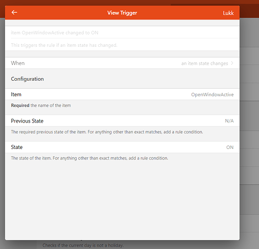

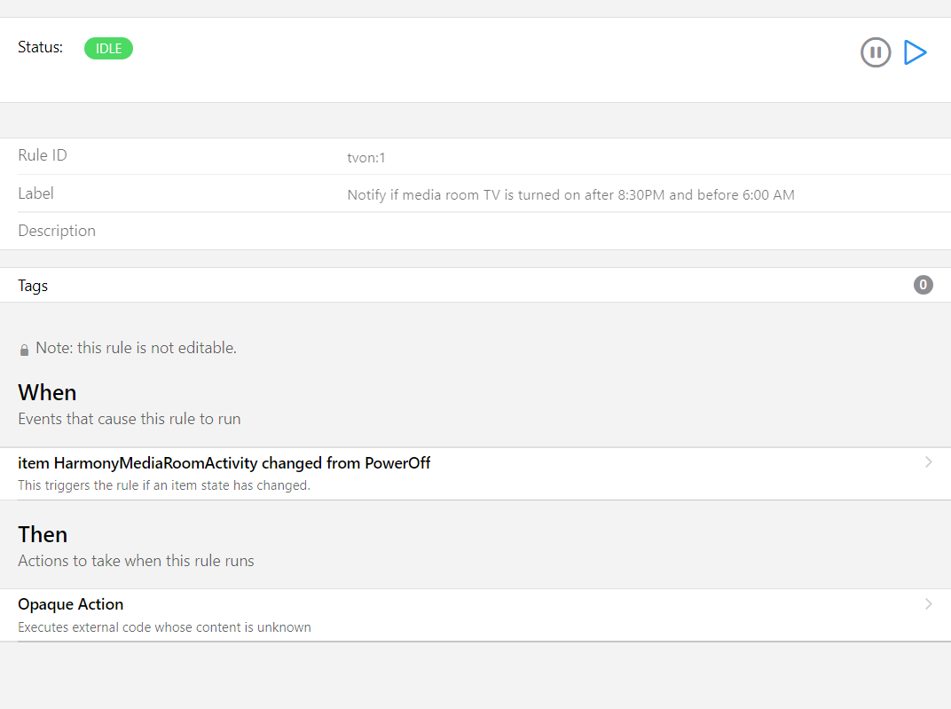

  • Does the rule page show the trigger correctly? YES - in this particular example, but there will be other cases when this will be wrong too.

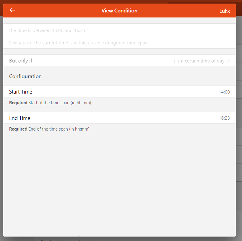

  • Does the rule page show the conditions correctly? NO. It does not show any conditions at all. This is incorrect. The rule indeed has a condition. Many of the conditions that you can define in JRuby cannot be represented in the rule page.

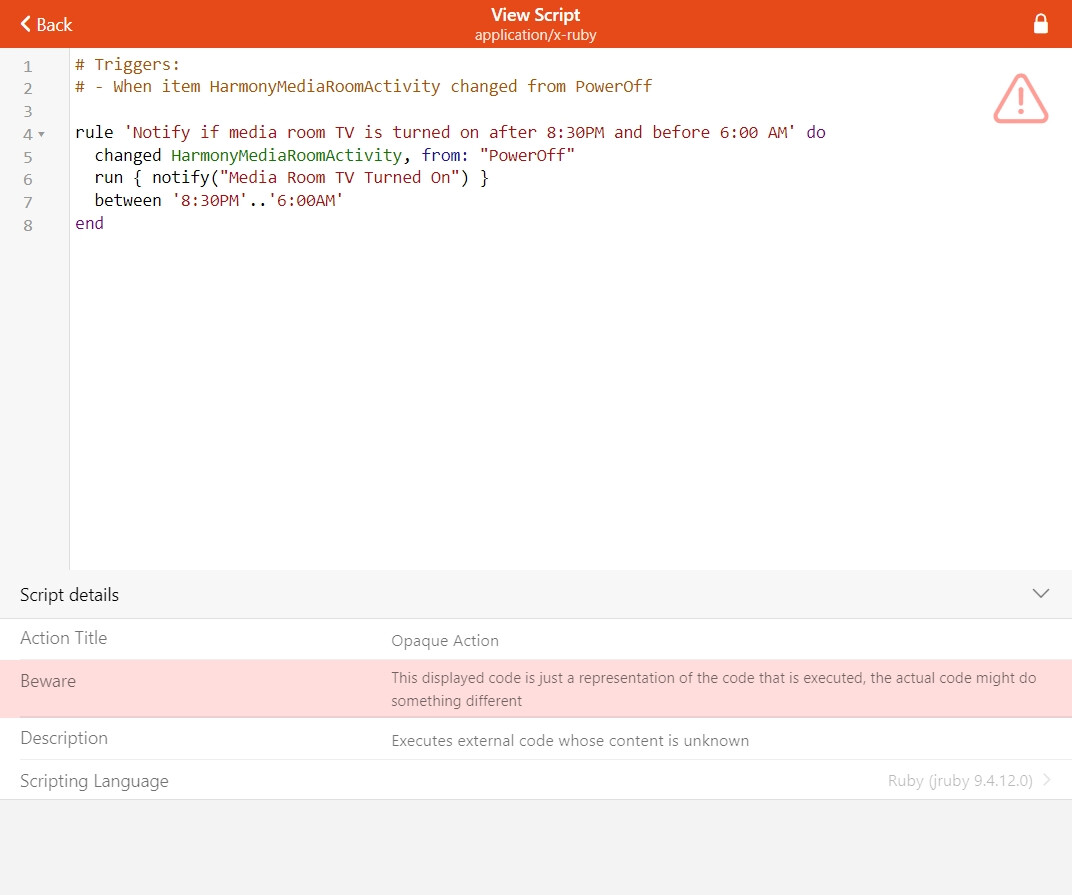

  • Does the rule page show the action correctly? NO. instead it shows the complete rule source. And you know this to be incorrect, that’s why you showed the triangle there.

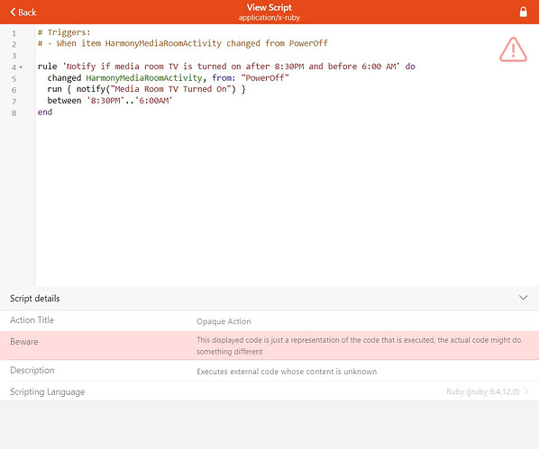

It says “Opaque Action - executes external code whose content is unknown”. Well that’s once again incorrect. If you look at the source code (as it is now in the Script Editor), everything is there. There’s nothing that’s unknown about it.
Your alternative proposal of showing the rule source code in the Code tab is slightly better. It solves the last problem above, but doesn’t solve the first two problems (trigger and conditions). However it will further confuse people because sometimes the Code tab shows YAML (for Managed / Full rule) vs Ruby / JS / whatever syntax.

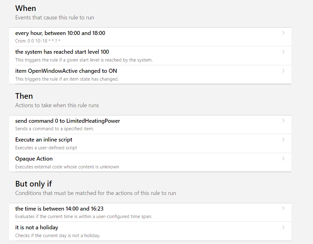

@jimtng As promised, I’ve finally managed to put together what I consider a “complex rule” using SimpleRule:

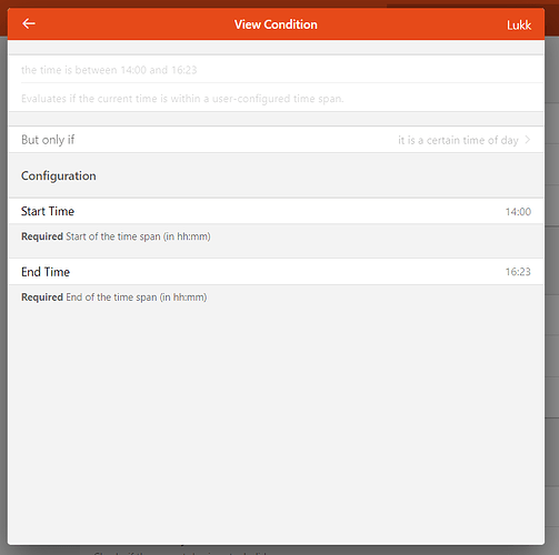

added_rule = $automationManager.add_rule(s_rule)
With “my code”, this is displayed on the rule page as this (The UID, name and tags are there, but are scrolled out of view):
With “standard OH” today, this rule is shown as this:
In addition, all the modules in the rule page are clickable, so you can get more information if you want to, e.g
(when clicking the scripted action (not the “opaque” one)):
I think the UI does a much better job at displaying such rules than the current solution.
