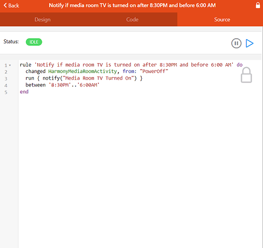

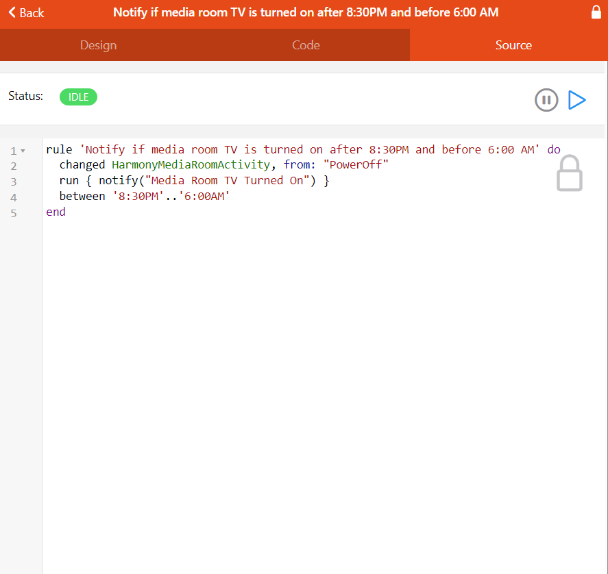

It’s premliminary and there are still some issues to figure out, but here’s a rough take:
I don’t know if the “bar” should be there or not, but it lets you see the status, disable/enable and run the rule manually.
