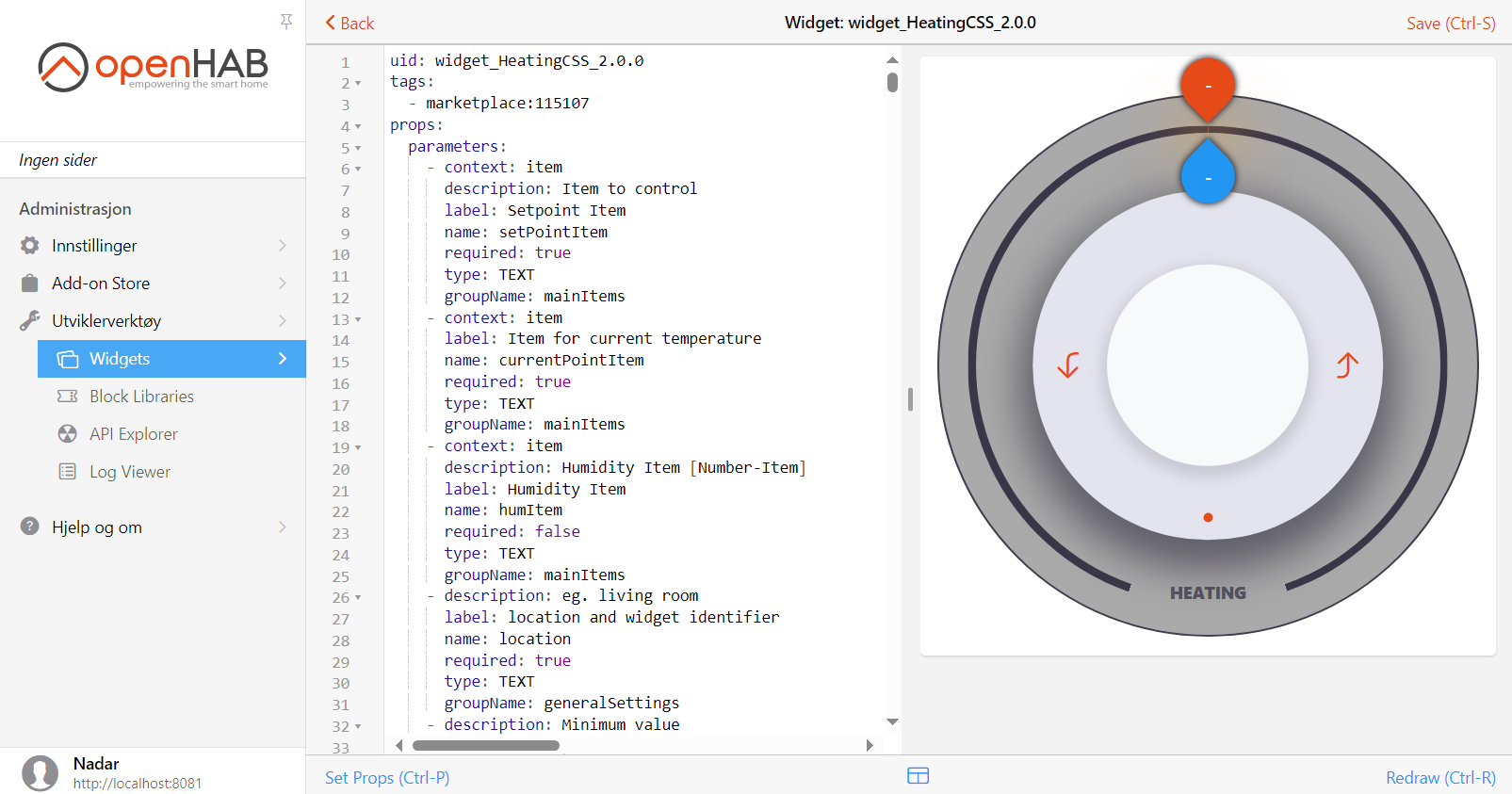

I found the method in the UI widget handler that determines if a widget add-on is “installed”:
    @Override
    public boolean isInstalled(String id) {
        return widgetRegistry.getAll().stream().anyMatch(w -> w.hasTag(id));
So, it’s that simple - that tag is the whole “coupling”. You can add a “marketplace tag” to any widget you have, and as long as it matches a “real marketplace widget” this widget will become “installed”, and uninstalling it will thus delete your widget. In the same manner, all you have to do to “make it your own” is to delete the marketplace tag.

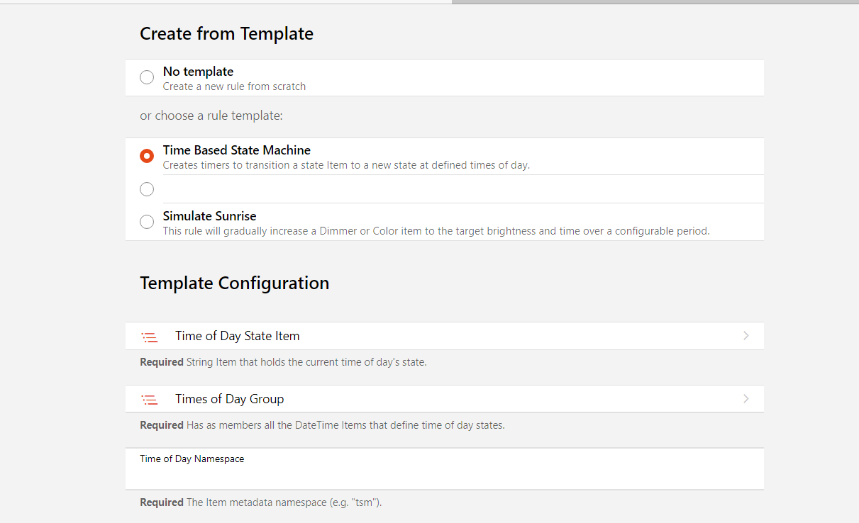

Absolutely complicated yes. I don’t fully know how templates and rules relate/work yet, but looking in the JSONDB after making a test rule, it seems like the rule is forever “tied” to the template:

To upgrade to a new rule template you currently must:
  1. remove the rule template
  2. refresh the page (not sure if this is still required)
  3. add the rule template
  4. navigate to a rule created from the rule template
  5. open the code tab and copy the configuration section (if there are more than one or two parameters) and paste it somewhere
  6. delete the rule
  7. create a new rule and choose the rule template and use the configurations from 5 to fill in the properties
  8. save
It sucks. But as with the UI widgets, you can remove the marketplace tag.
Currently, that isn’t the case. Once the rule is created and saved, it stands on its own and continues to exist independent of the rule template.

I ran this rule templace through a YAML to JSON converter to get this:
  "uid": "rules_tools:tsm",
  "label": "Time Based State Machine",
  "description": "Creates timers to transition a state Item to a new state at defined times of day.",
  "configDescriptions": [
      "name": "timeOfDay",
      "type": "TEXT",
      "context": "item",
      "filterCriteria": [
          "name": "type",
          "value": "String"
      "label": "Time of Day State Item",
      "required": true,
      "description": "String Item that holds the current time of day's state."
      "name": "timesOfDayGrp",
      "type": "TEXT",
      "context": "item",
      "filterCriteria": [
          "name": "type",
          "value": "Group"
      "label": "Times of Day Group",
      "required": true,
      "description": "Has as members all the DateTime Items that define time of day states."
      "name": "namespace",
      "type": "TEXT",
      "label": "Time of Day Namespace",
      "required": true,
      "description": "The Item metadata namespace (e.g. \"tsm\")."
  "triggers": [
      "id": "1",
      "configuration": {
        "groupName": "{{timesOfDayGrp}}"
      "type": "core.GroupStateChangeTrigger"
      "id": "2",
      "configuration": {
        "startlevel": 100
      "type": "core.SystemStartlevelTrigger"
      "id": "4",
      "configuration": {
        "time": "00:05"
      "type": "timer.TimeOfDayTrigger"
  "conditions": [],
  "actions": [
      "inputs": {},
      "id": "3",
      "configuration": {
        "type": "application/javascript",
        "script": "// Version 1.0\nvar {TimerMgr, helpers} = require('openhab_rules_tools');\nconsole.loggerName = 'org.openhab.automation.rules_tools.TimeStateMachine';\n//osgi.getService('org.apache.karaf.log.core.LogService').setLevel(console.loggerName, 'DEBUG');\n\nhelpers.validateLibraries('4.2.0', '2.0.3');\n\nconsole.debug('Starting state machine in ten seconds...');\n\n// Properties\nvar STATE_ITEM  = \"{{timeOfDay}}\";\nvar DT_GROUP    = \"{{timesOfDayGrp}}\";\nvar DAY_TYPES   = ['custom', 'holiday', 'dayset', 'weekend', 'weekday', 'default'];\nvar NAMESPACE   = '{{namespace}}';\nvar USAGE =   'Time Based State Machine Usage:\\n'\n            + 'All date times must be a member of ' + DT_GROUP + '.\\n'\n            + 'Each member of the Group must have ' + NAMESPACE + ' Item metadata of the following format:\\n'\n            + '  .items file: ' + NAMESPACE +'=\"STATE\"[type=\"daytype\", set=\"dayset\", file=\"uri\"]\\n'\n            + \"  UI YAML: use '\" + NAMESPACE + \"' for the namespace and metadata format:\\n\"\n            + '    value: STATE\\n'\n            + '    config:\\n'\n            + '      type: daytype\\n'\n            + '      set: dayset\\n'\n            + '      file: uri\\n'\n            + 'Where \"STATE\" is the state machine state that begins at the time stored in that Item, '\n            + '\"daytype\" is one of \"default\", \"weekday\", \"weekend\", \"dayset\", \"holiday\", or \"custom\". '\n            + 'If \"dayset\" is chosen for the type, the \"set\" property is required indicating the name of the '\n            + 'custom dayset configured in Ephemeris. If \"custom\" is chosen as the type, the \"file\" property '\n            + 'is required and should be the fully qualified path the the Ephemeris XML file with the custom '\n            + 'holidays defined. The \"set\" and \"file\" properties are invalid when choosing any of the other '\n            + '\"types\".';\n\n/**\n * Validates the passed in Item has valid NAMESPACE metadata.\n *\n * @param {string} itemName name of the Item to check\n * @throws exception if the metadata doesn't exist or is invalid\n */\nvar validateItemConfig = (itemName) => {\n  const md = items[itemName].getMetadata()[NAMESPACE];\n\n  if(md.value === undefined || md.value === null || md.value === '') {\n    throw itemName + ' has malformed ' + NAMESPACE + ' metadata, no value found!';\n  }\n\n  const dayType = md.configuration['type'];\n  if(!dayType) {\n    throw itemName + ' has malformed ' + NAMESPACE + ' metadata, required \"type\" property is not found!';\n  }\n\n  if(dayType == 'dayset' && !md.configuration['set']) {\n    throw itemName + ' has malformed ' + NAMESPACE + ' metadata, type is \"dayset\" but required \"set\" property is not found!';\n  }\n\n  if(dayType == 'custom' && !md.configuration['file']) {\n    throw itemName + ' has malformed ' + NAMESPACE + ' metadata, type is \"custom\" but required \"file\" property is not found!';\n  }\n\n  if(!items[itemName].type.startsWith('DateTime')) {\n    throw itemName + ' is not a DateTime Item!';\n  }\n\n  if(items[itemName].isUninitialized) {\n    throw itemName + \" is not initialized!: \" + items[itemName].state;\n  }\n\n  console.debug(itemName+ ' is valid');\n};\n\n/**\n * Return all members of the DT_GROUP that has a \"type\" metadata configuration property that\n * matches the passed in type.\n *\n * @param {string} type the day type defined in the metadata we want to get the Items for\n * @returns {Array} all the Items with the matching type in the metadata\n */\nvar getItemsOfType = (type) => {\n  const allItems = items[DT_GROUP].members;\n  return allItems.filter( item => item.getMetadata()[NAMESPACE].configuration['type'] == type);\n};\n\n/**\n * Returns true if all the Items of the given type have a unique \"state\" value\n * in the metadata.\n *\n * @param {string} the day type\n * @returns {boolean} true if all states are unique, false otherwise\n */\nvar checkUniqueStates = (type) => {\n  const allItems = getItemsOfType(type);\n  const states = new Set(allItems.map(i => { return i.getMetadata()[NAMESPACE].value; }));\n  return !allItems.length || allItems.length == states.size;\n};\n\n/**\n * Check that all Items are configured correctly.\n */\nvar validateAllConfigs = () => {\n  console.debug('Validating Item types, Item metadata, and Group membership');\n\n  // Check that all members of the Group have metadata\n  const itemsWithMD = items[DT_GROUP].members.filter(item => item.getMetadata(NAMESPACE)).length;\n  if(itemsWithMD != items[DT_GROUP].members.length) {\n    const noMdItems = items[DT_GROUP].members.filter(item => !item.getMetadata(NAMESPACE));\n    console.warn('The following Items do not have required ' + NAMESPACE + ' metadata: ' + noMdItems.map(item => item.name).join(', '));\n    return false; // no sense on performing any additional tests\n  }\n\n  // Check each Item's metadata\n  let isGood = helpers.checkGrpAndMetadata(NAMESPACE, DT_GROUP, validateItemConfig, USAGE);\n\n  // Check the state item\n  if(!items[STATE_ITEM]){\n    console.warn('The state Item ' + STATE_ITEM + ' does not exist!');\n    isGood = false;\n  }\n\n  if(!items[STATE_ITEM].type.startsWith('String')) {\n    console.warn('The state Item ' + STATE_ITEM + ' is not a String Item!');\n    isGood = false;\n  }\n\n  // Check to see if we have a default set of Items\n  if(!getItemsOfType('default')) {\n    console.warn('There are no \"default\" day type Items defined! Make sure you have all day types covered!');\n    // we'll not invalidate if there are no \"default\" items\n  }\n\n  // Check that each data set has a unique state for each Item\n  DAY_TYPES.forEach(type => {\n    if(!checkUniqueStates(type)) {\n      console.warn('Not all the metadata values for Items of type ' + type + ' are unique!');\n      isGood = false;\n    }\n  })\n\n  // Report if all configs are good or not\n  if(isGood) {\n    console.debug('All ' + NAMESPACE + ' Items are configured correctly');\n  }\n  return isGood;\n};\n\n/**\n * Pull the set of Items for today based on Ephemeris. The Ephemeris hierarchy is\n * - custom\n * - holiday\n * - dayset\n * - weeekend\n * - weekday\n * - default\n *\n * If there are no DateTime Items defined for today's type, null is returned.\n */\nvar getTodayItems = () => {\n  // Get all the DateTime Items that might apply to today given what type of day it is\n  // For example, if it's a weekend, there will be no weekday Items pulled. Whether or not\n  // the entry in this dict has an array of Items determines whether today is of that day\n  // type.\n  const startTimes = [\n    { 'type': 'custom',  'times' : getItemsOfType('custom').filter(item => actions.Ephemeris.isBankHoliday(0, item.getMetadata()[NAMESPACE].configuration['file'])) },\n    { 'type': 'holiday', 'times' : (actions.Ephemeris.isBankHoliday()) ? getItemsOfType('holiday') : [] },\n    { 'type': 'dayset',  'times' : getItemsOfType('dayset').filter(item => actions.Ephemeris.isInDayset(items.getMetadata()[NAMESPACE].configuration['set'])) },\n    { 'type': 'weekend', 'times' : (actions.Ephemeris.isWeekend()) ? getItemsOfType('weekend') : [] },\n    { 'type': 'weekday', 'times' : (!actions.Ephemeris.isWeekend()) ? getItemsOfType('weekday') : [] },\n    { 'type': 'default', 'times' : getItemsOfType('default') }\n  ];\n\n  // Go through startTimes in order and choose the first one that has a non-empty list of Items\n  const dayStartTimes = startTimes.find(dayset => dayset.times.length);\n\n  if(dayStartTimes === null) {\n    console.warn('No DateTime Items found for today');\n    return null;\n  }\n  else {\n    console.info('Today is a ' + dayStartTimes.type + ' day.');\n    return dayStartTimes.times;\n  }\n};\n\n/**\n * Returns a function called to transition the state machine from one state to the next\n *\n * @param {string} state the new state to transition to\n * @param {function} the function that transitions the state\n */\nvar stateTransitionGenerator = (state) => {\n  return function() {\n    console.info('Transitioning Time State Machine from ' + items[STATE_ITEM].state + ' to ' + state);\n    items[STATE_ITEM].sendCommand(state);\n  }\n}\n\n/**\n * Returns a function that generates the timers for all the passed in startTimes\n *\n * @param {Array} startTimes list of today's state start times\n * @param {timerMgr.TimerMgr} timers collection of timers\n * @returns {function} called to generate the timers to transition between the states\n */\nvar createTimersGenerator = (timers) => {\n  return function() {\n\n    if(validateAllConfigs()) {\n\n      // Cancel the timers, skipping the debounce timer\n      console.debug('Cancelling existing timers');\n      timers.cancelAll();\n\n      // Get the set of Items for today's state machine\n      console.debug(\"Acquiring today's state start times\");\n      const startTimes = getTodayItems();\n\n      // Get the state and start time, sort them ignoring the date, skip the ones that have\n      // already passed and create a timer to transition for the rest.\n      console.debug('Creating timers for times that have not already passed');\n      var mapped = startTimes.map(i => { return { 'state': i.getMetadata()[NAMESPACE].value,\n                                                  'time' : time.toZDT(i.state).toToday() } });\n      mapped.sort((a,b) => {\n               if(a.time.isBefore(b.time)) return -1;\n                else if(a.time.isAfter(b.time)) return 1;\n                else return 0;\n              })\n              .filter(tod => tod.time.isAfter(time.toZDT()))\n              .forEach(tod => {\n                // TODO: see if we can move to rules instead of timers\n                console.debug('Creating timer for ' + tod.state + ' at ' + tod.time);\n                timers.check(tod.state, tod.time.toString(), stateTransitionGenerator(tod.state));\n              });\n\n      // Figure out the current time of day and move to that state if necessary\n      var beforeTimes = mapped.sort((a,b) => {\n                                if(a.time.isAfter(b.time)) return -1;\n                                else if(a.time.isBefore(b.time)) return 1;\n                                else return 0;\n                              })\n                              .filter(tod => tod.time.isBefore(time.toZDT()));\n      if(!beforeTimes.length) {\n        console.debug(\"There is no date time for today before now, we can't know what the current state is, keeping the current time of day state of \" + items[STATE_ITEM].state + \".\");\n      }\n      else {\n        const currState = beforeTimes[0].state\n        const stateItem = items[STATE_ITEM];\n        console.info('The current state is ' + currState);\n        if(stateItem.state != currState) stateItem.sendCommand(currState)\n      }\n    }\n    else {\n      console.warn('The config is not valid, cannot proceed!');\n    }\n\n  };\n};\n\nvar timers = cache.private.get('timers', () => TimerMgr());\n\n// Wait a minute after the last time the rule is triggered to make sure all Items are done changing (e.g.\n// Astro Items) before calculating the new state.\ntimers.check('debounce',\n             'PT10S',\n             createTimersGenerator(timers),\n             true,\n             () => { console.debug('Flapping detected, waiting before creating timers for today'); });\n"
      "type": "script.ScriptAction"
I then stored that in a file in the “templates” folder, and my UI now shows (ignore the empty entry, it’s from my test with an empty file):
So, it seems to be working on a fundamental level at least. I can’t get JS to work on the “demo.app”, so I can’t test anything using JS, so I can’t do any further testing that seeing that it appears. Do you know if a rules DSL rules template exists - that one I should be able to actually test?
