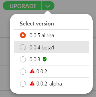

I’ve got the “split button” to more or less work now, and just want to explain my thinking: For add-ons without multiple versions, the button won’t be split and will look just like today. For add-ons with multiple (available, depends on compatibility range and published/stable status) versions, the split button will be shown. As only one such add-on currently exists on the marketplace, all testing is done with my “test add-on”.
I strongly dislike “modern” UI design, so I don’t even want to try to make something that “slick”/“modern”. Instead, I’ve just added examples to show how the versions can be styled based on functionality. I really wish somebody will come up with something better if this comes to anything. The styling can be whatever one wants to anyway, the different versions are “tagged” with different CSS classes.
In my example, the circle indicates the currently selected version. The one with a gray background is the currently installed version (if any), the green sheld indicates the latest stable version and the red triangles indicate versions incompatible with the current OH installation. The incompatible ones will only be shown if “Include (Potentially) Incompatible Add-ons” is enabled in the “Add-on Management” settings. It’s probably unlikely that a “real world” add-on would look like this, but I need to test all options.

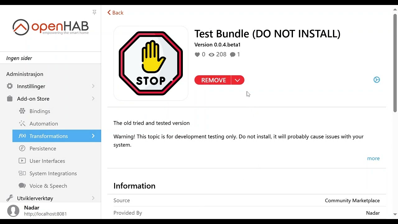

Here is a quick demonstration of how this currently works:
This is pretty nice - if the backend follows.
